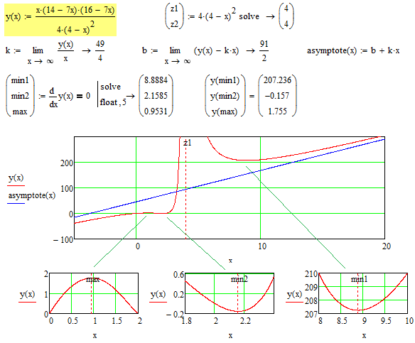

You can not only plot a graph but do an analyses the function (as my students):
And zeros too:
