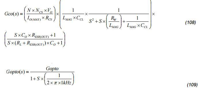

I am fairly new to Mathcad and I am trying to do the following from the data sheet. I need to make both of these plots and haven't got a clue where to start. If anyone can help it would be REALLY appreciated.

Here is what I have tried so far

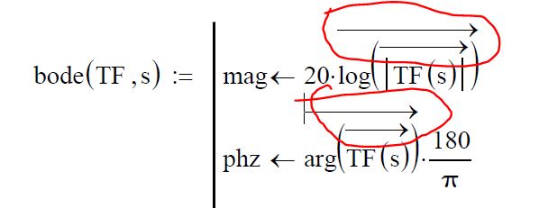

Aug 18, 2015 12:17 PM UTC
Hi Andy,
Andy here. In your excellent Amplifier Gain file, it's not clear to me what the nested vectorization inside the bode function accomplishes. When I eliminate the outer vectorization from your bode program, the output does not change. Is there something esoteric about the outer vectorization that this neophyte is missing.
