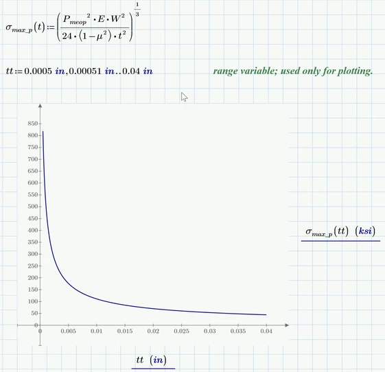

Thank you, Luc - It was such a silly mistake on my part. Thanks for noticing it, and appreciate your feedback.
Yo get a smoother plot if you define sigma as a function of "t" rather than a vector of a few values.
thodij6-ContributorAuthor
6-Contributor
Werner, thank you for enlightening me on this, and for caring about this plotting question. The PTC community is wonderful!
