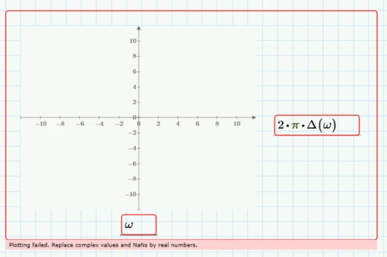

Plotting failed for Dirac Delta (Unit Impulse) Function. Why?
Do I need to define the dirac delta (unit impulse) function separately to be able to use (plot) it?
Mathcad Prime 8 file attached.

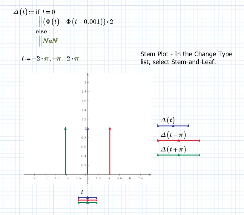

ttokoroAnswer
Apr 20, 2023 12:40 AM UTC
Change plot type as below.
t.t.

Apr 19, 2023 7:57 AM UTC
The Dirac impulse has infinite amplitude and infinitesimal width. You can never make a graph of it. You can make some approximations, for example with a rectangular impulse of amplitude 1/ε and width ε so that the area of the impulse is always unitary.  with ε small as desired.

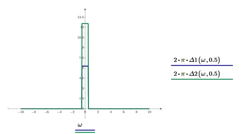

Which is more correct to use between delta1 and delta2 function implementations?
Cornel19-TanzaniteAuthor
Apr 19, 2023 8:20 AM UTC
But then...I do not know if I will can evaluate numerically further with this functions defined above.
Which should have the value of 1, right?
