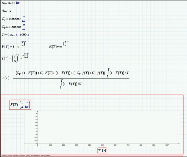

I have an MatchCAD Prime issues. Plotting the equation in MatchCAD Prime 7.0 is not working. There is notification like this "Plotting failed. Replace complex values and NaN by real numbers".

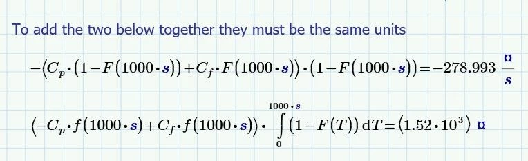

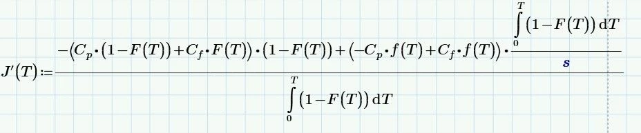

Change the following line to match units.

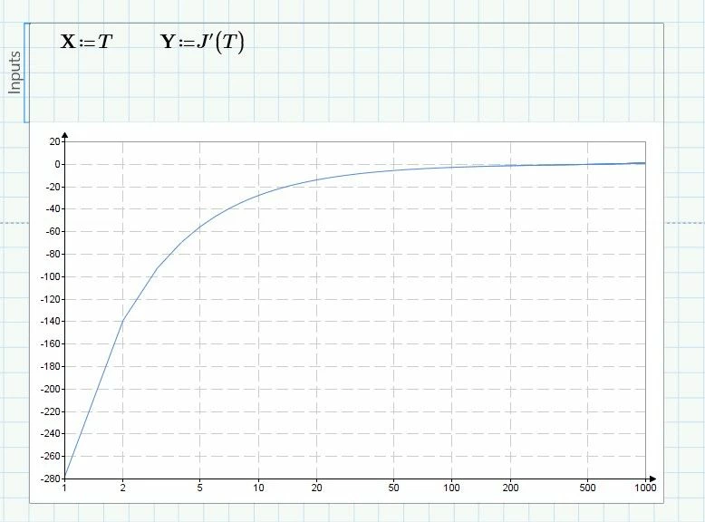

You get a better graph with the chart component.

Thank You. Btw, Why do we have to include the letter "s" here?
terryhendicott
The "s" is the unit of seconds.  For unit consistency you need to divide the second term by seconds
