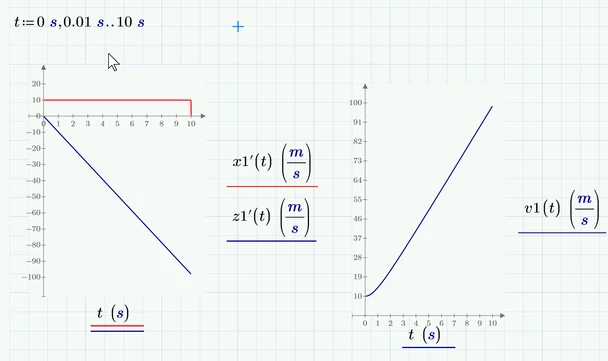

I am new to MathCad. I plotted the freefall equation and solved for x and z. Then I would like to plot the velocity, so x' and z' but get the error: "replace with complex values and NaNs by real numbers". It shouldn't have complex values and NaNs, I have checked the odesolve syntax, the time step and the units, but still can't find the mistake.
Would appreciate help! The file is attached.

You may consider using a simple range variable for t rather than the vector you used.
I am not quite sure why Prime has problems with the way you had set up the sheet - it should work OK. But Prime seems to have problems with the combination of the vector t and the derivative operator. We may call it a bug.

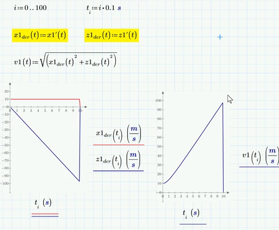

Another way around this problem/bug is to define the derivatives as separate functions and use these:

There's something weird going on in your sheet.
The two functions x1'(t) and z1'(t) are not defined which I think is what causes the error message for your plot.
But I would have expected an error message at the definition of v1(t), which uses those two undefined functions.

I thought it is enough to define the u0 and v0, and when solving x and z, it should calculate x'(t) and z'(t). If I insert a single value for t, I also get a plausible answer.
Do you have an idea why I get these results as well as the plot v1(t)?

ok, thank you Werner!
