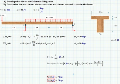

Plotting failed. Replace complex values and NaNs by real numbers.
Can you please help me solve this issue? I don't see any faults on equation. Please let me know if I am overlooking at something.
Thank you.

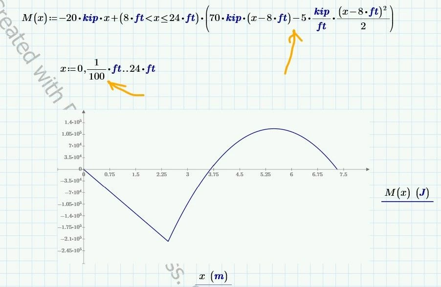

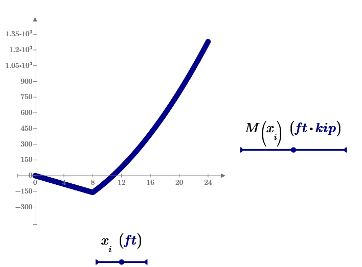

terryhendicott
Apr 30, 2024 7:29 AM UTC
Alter the sign of the uniform load in the moment equation.
Be realistic about the interval in x about 0.12"
Graph of M should be zero at E
Cheers
Terry

ttokoro
Apr 30, 2024 4:55 AM UTC
Only correct Mathcad error by adding ft unit to 8. I have no idea about your function.
t.t.

3-Newcomer
Apr 30, 2024 11:13 AM UTC
Thank you so much!
