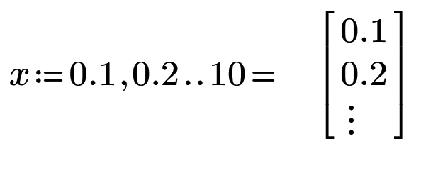

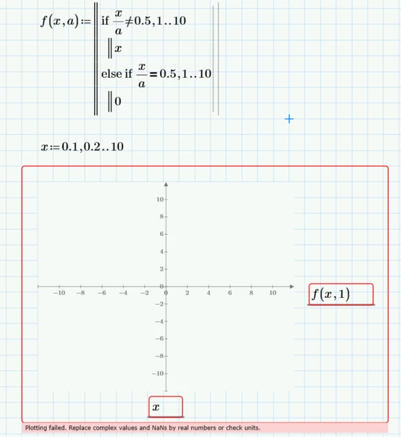

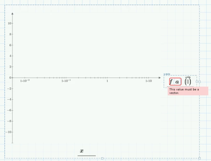

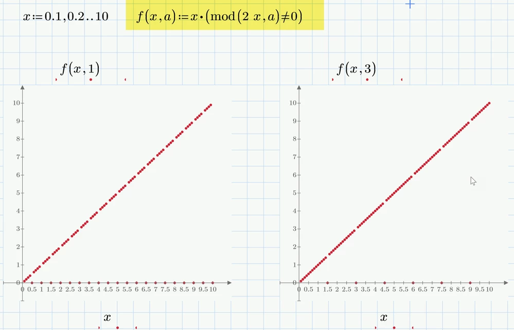

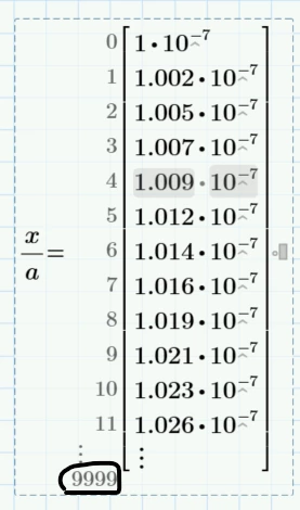

The answer to your question:
Because x/a is a scalar when f(x,a) is called through a plot and you cannot compare a scalar with a range.
Here are my 2 cents worth

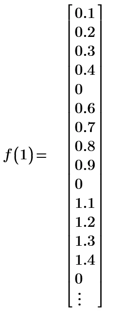

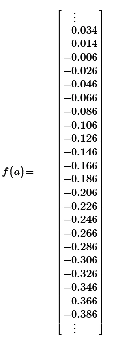

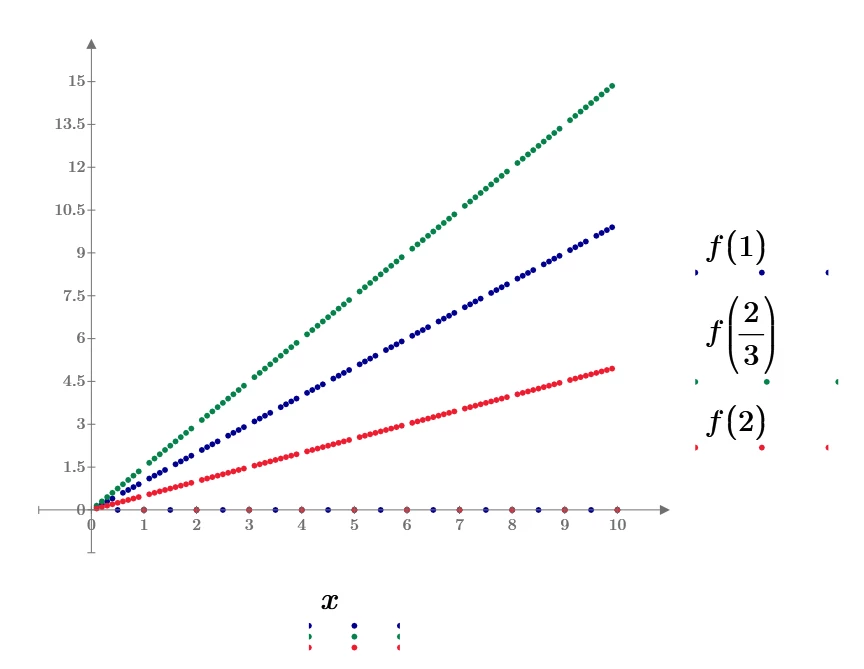

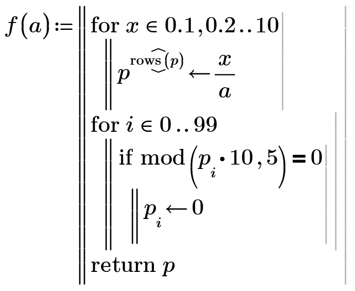

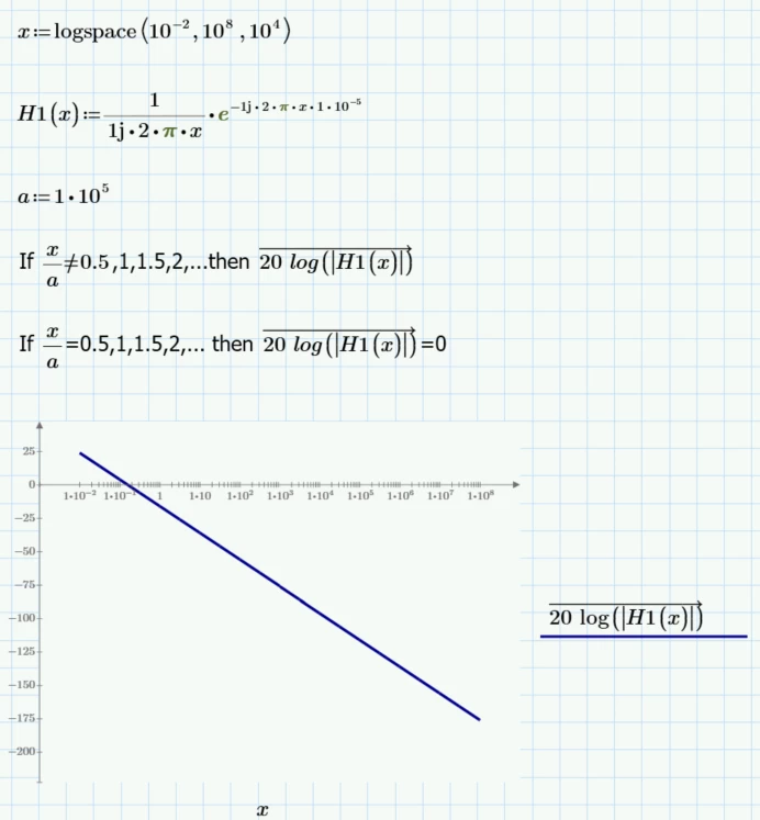

Cornel19-TanzaniteAuthor
How can be made for this @ttokoro

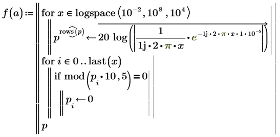

An how to see when, at what position x/a=0.5, 1, 1.5, 2, etc... as there are 10000 elements...
ttokoro

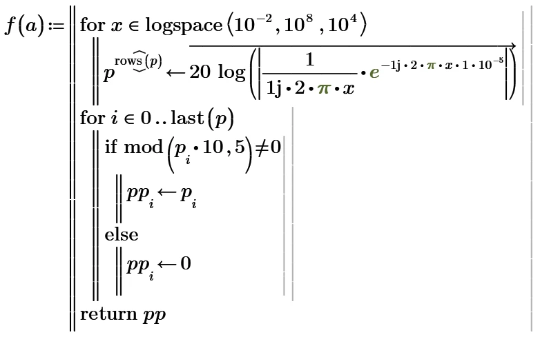

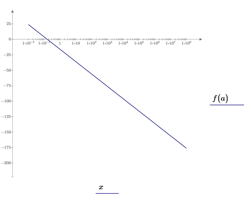

mod condition does not match. So return no data. Not last(x) but last(p). Add else condition.
