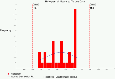

About this worksheet:
This worksheet shows you how to use PTC Mathcad to calculate a frequency distribution for values in a vector that fall in a specified number of bins within the range of the data, and how to plot the resulting histogram. There is step by step instruction on how to enter a vector of torque data and an in-depth overview of the Outliner Limit Equation, as well as a description and graph of a Shewhart plot. This worksheet provides a particular data set for Torque and demonstrates how you would solve using PTC Mathcad. Instruction, notation, formulas, equations, and 4 separate graphs are included to aid you.
