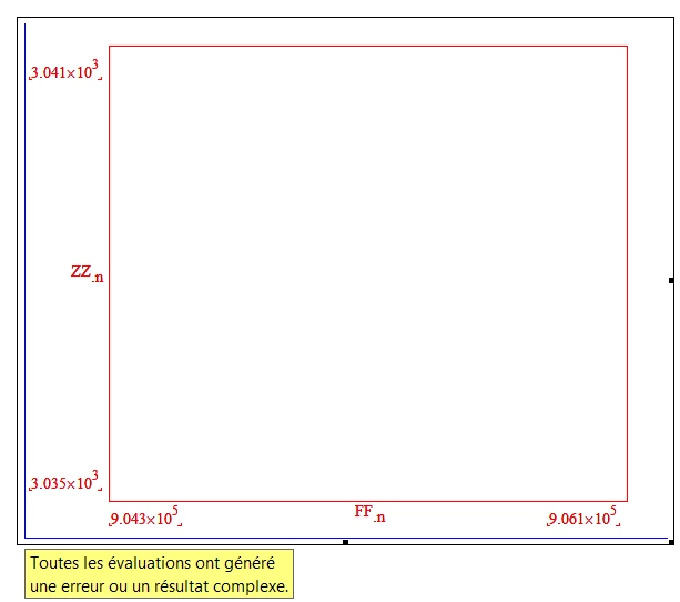

hello, I would like some help with: I inserted the text file, but I don't have a graphic.
thank you very much in advance

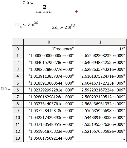

The "values" of your imported data actually are not numbers but rather text strings (you can tell by the quotes around them). Thats the reason why your plot attempt fails.
Can you post the Mathcad sheet and the excel file for examination?
EDIT: Ahh, I see that Terry has beaten me for four minutes 😉
Actually the header strings would not result in an error in a 2D plot, they simply would be ignored.
The error occurs because all "data" are strings.
Nonetheless, I would consider it good habit to get rid of the columns labels and just work with the pure numerical data.

The headers to the data in row 0 cannot be plotted.  Adjust the properties of the data input to start from second row.
The numbers in Z10 are actually text indicated by double quotes.
Upload you xmcd file and the data file so input can be corrected for you.

Apr 5, 2024 10:20 PM UTC
Thanks to your help the problem solved, thank you very much
