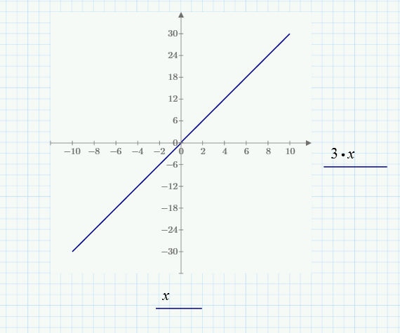

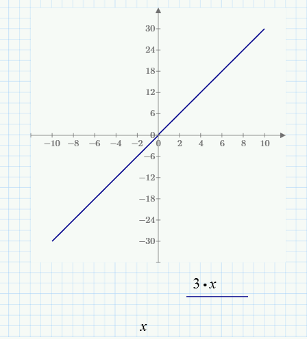

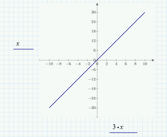

That's amazing!  Thanks.  But it could lead to some truly wonderfully misleading plots:
