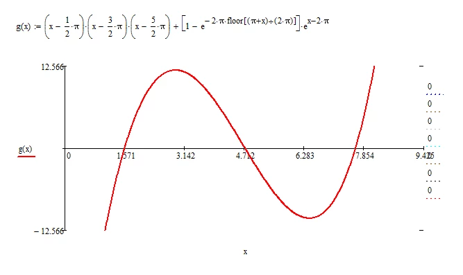

Hello Everyone.
From :
1.PNGPlotting local max-min-points ?
Thanks in advance.

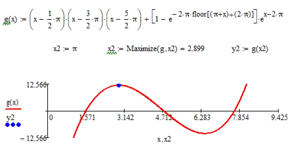

One possibility as follows:
Alan

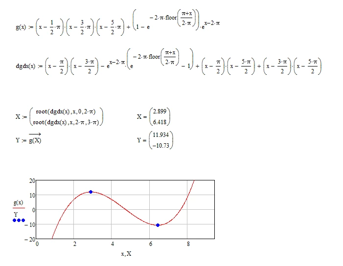

After got hints :

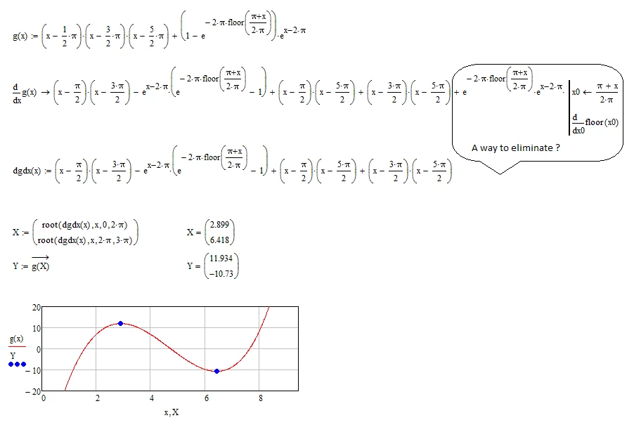

1b-.PNGA way to eliminate the 'oval' ?
Regards.

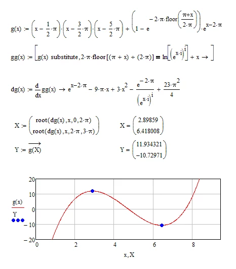

So far I propose one of solution : ( and any other idea would be appreciated )
