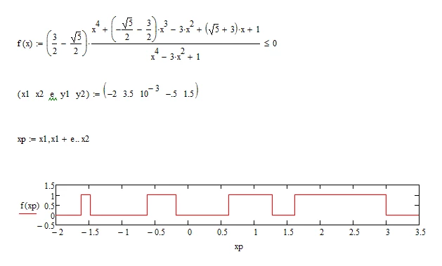

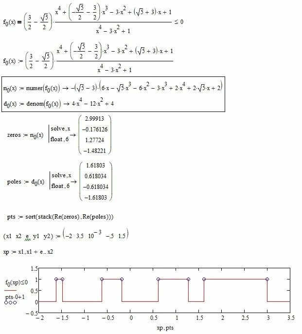

   Hello, Everyone.
   From :
  How to plot 8 upper-corner-points ?
     Thanks in advance.
         Regards.
LucMeekesAnswer
23-Emerald V
October 19, 2018
Like this:

   Your method to solve it, this is a new to me ! Smiley HappySmiley HappySmiley Happy Many thanks for your time and help, Luc. I got it. Smiley HappySmiley HappySmiley Happy
        Best Regards.
October 19, 2018

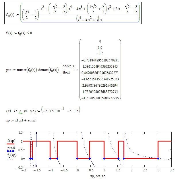

You could also use the "numer" and  "denom" functions as shown:
October 19, 2018

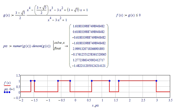

or more compact:

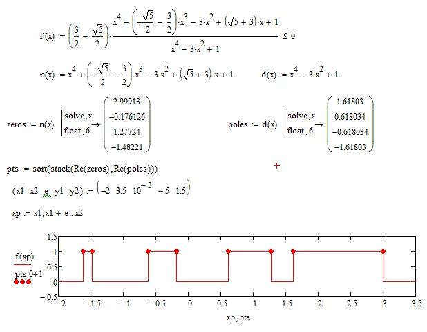

lvl10720-TurquoiseAuthor
20-Turquoise
October 19, 2018
  F.M. and Werner, with your "procedures" above, It seems that I just need "input" a new function ! Smiley HappySmiley HappySmiley Happy :
  Many thanks for all your time and help.
