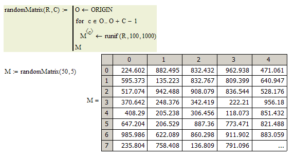

I have a matrix column M with a total of n rows, and I want to plot how the components M(n,1) change in function of n. Is there any way in Mathcad to do this?

OK, lets first create a dummy matrix with random values:
Now two ways to get the plot you are looking for:
1) Create a vector with row indices (here values from 0 to 49) and plot the first column over this vector
2) Create a suitable range variable (here from 0 to 49) and plot M(n,0) over that range
