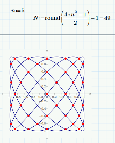

Plotting the points of intersection on the graph ?

Emperically:

The points where the curve intersects with itself are plotted on the graph.... along with a lot of other points.
If you want the coordinates of the intersection points plotted in readable text next to them, you need to define a few more curves to get them in.

   How many points of intersection on the graph ?
23-Emerald V
March 17, 2017
Sorry, I misunderstood your original question.
To solve the problem at hand, I would mathematically create the lissajous-shape in 3D, then make a projection of it on a (2D) surface and find the intersecting points of it.
Why the detour? because now you only have two expressions, and a single running variable. I see no path where that brings you to more than 2 solutions.

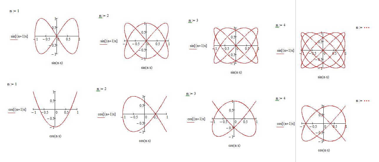

    I greatly appreciate all of your time and help. Werner, Luc, and Fred.       . I'm very, very happy. And I think I still need help with the two of question, the above, on cos(  ) function :
              Thanks in advance.

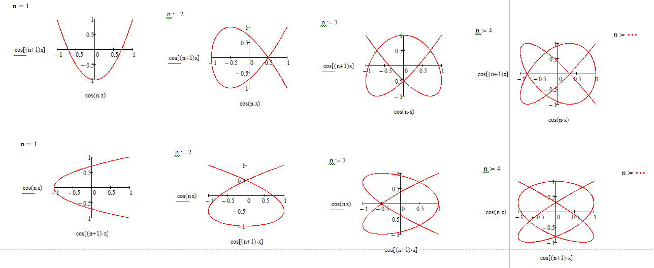

  From :
  So I have a query : How to rotate a graph (pi/2) clockwise and (pi/2) counter-clockwise ?
        Best Regards.
              Loi
March 18, 2017
clockwise: replace the x(t) on the abscissa by y(t) and the y(t) on the ordinate by -x(t)
counter clockwise: replace the x(t) on the abscissa by -y(t) and the y(t) on the ordinate by x(t)
