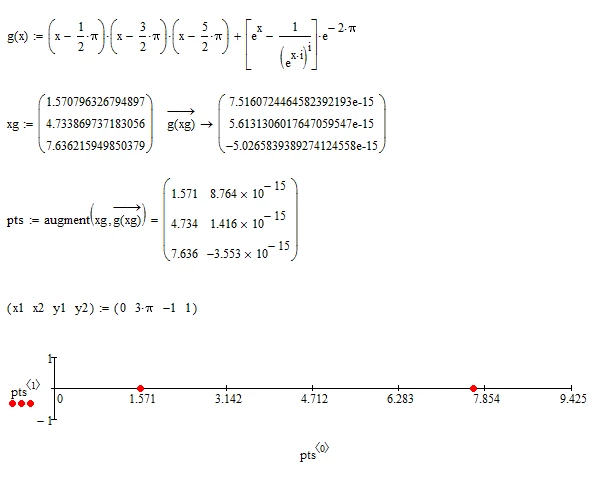

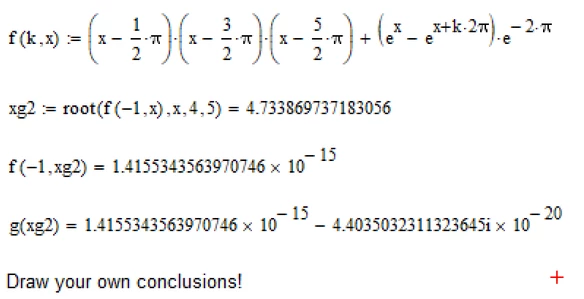

As Werner shows, there is an imaginary component to the second point (that is small enough that it apparently doesn't show in your version.)  The solution would be to specify only the real portions {Re(g(x))}.

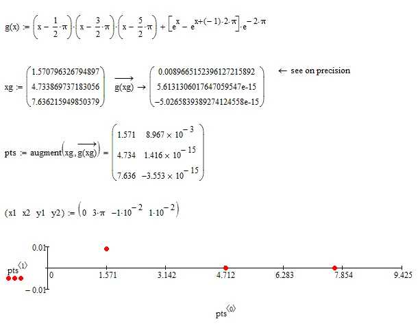

Werner, I very sorry about my questionSmiley Sad. My question would be : "Is there a way to plot the third root-point  ?"
2.PNGBest Regards.
November 4, 2018
Sure!
Or you may consider Freds suggestion.

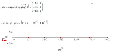

November 4, 2018
lvl10720-TurquoiseAuthor
20-Turquoise
November 4, 2018
Yes, yes... I guess so. Many many thanks, Fred.Smiley HappySmiley HappySmiley Happy. The point doesn't show in my Mathcad15 (version).
Many thanks again, Fred.
Best Regards.
Loi.

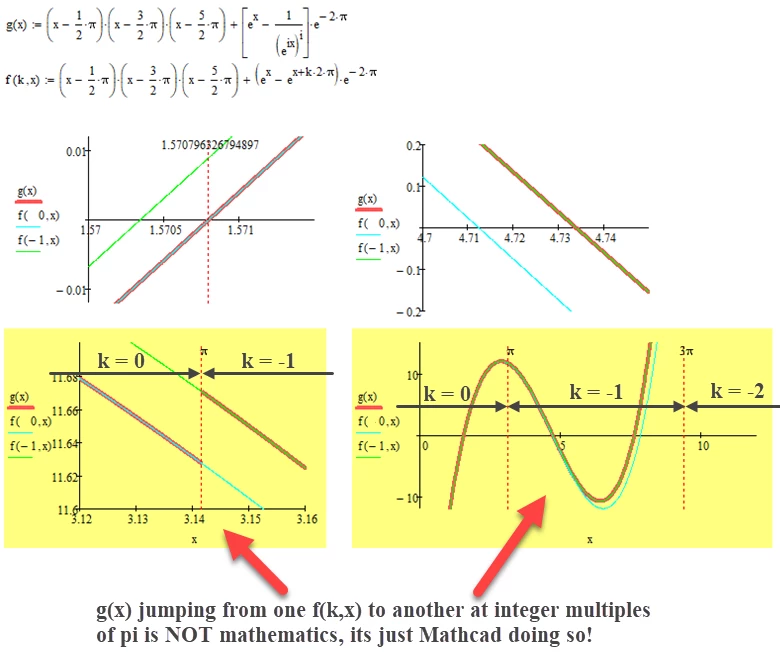

November 4, 2018
I bet it does if you do the same as I did. Look at how I modified the definition of pts.
Some day even you will realize that Mathcad simply can't handle a family of functions defined like g(x) as we would like it to do and you can't expect that just one single k in f(k,x) can equal what Mathcad does with g(x).
You have a different k for every interval of length 2 pi!
One last try:
