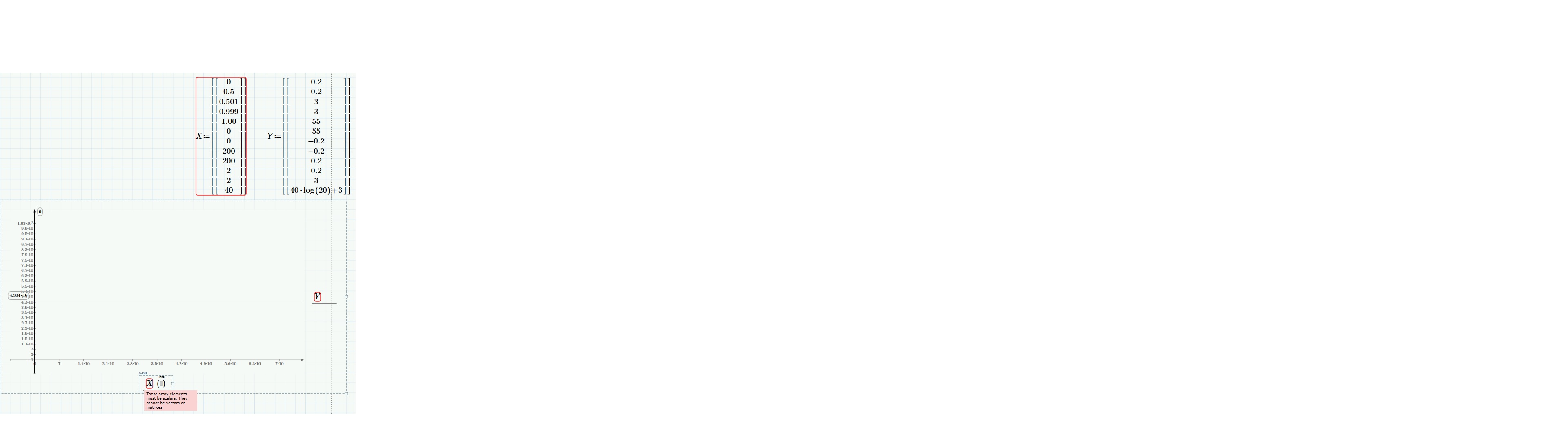

Can anyone help with this error in the attached file? Does Mathcad 3.1 allow plotting vectors or matrices?
Yes. Unfortunately I can't tell what is wrong because Prime 3.0 can't read a Prime 3.1 file.

As for what is wrong, I can't make the file to be 3.0 readable. Anyway, I inserted a screen shot for those who can't open the version 3.1 files.
RichardJ19-TanzaniteAnswer
Apr 22, 2015 3:44 PM UTC
I know. It's ridiculous that version 3.1 can't share data with version 3.0, but that's the way it is.
You have a vector within a vector (note the double braces on each side). Nested arrays like that are allowed in Mathcad, but you can't plot them against each other. Delete one set of braces.
Apr 24, 2015 2:02 PM UTC
Please find in attachment your edited worksheet. Now it works fine in your Prime version?

Vladimir,
It does work.
