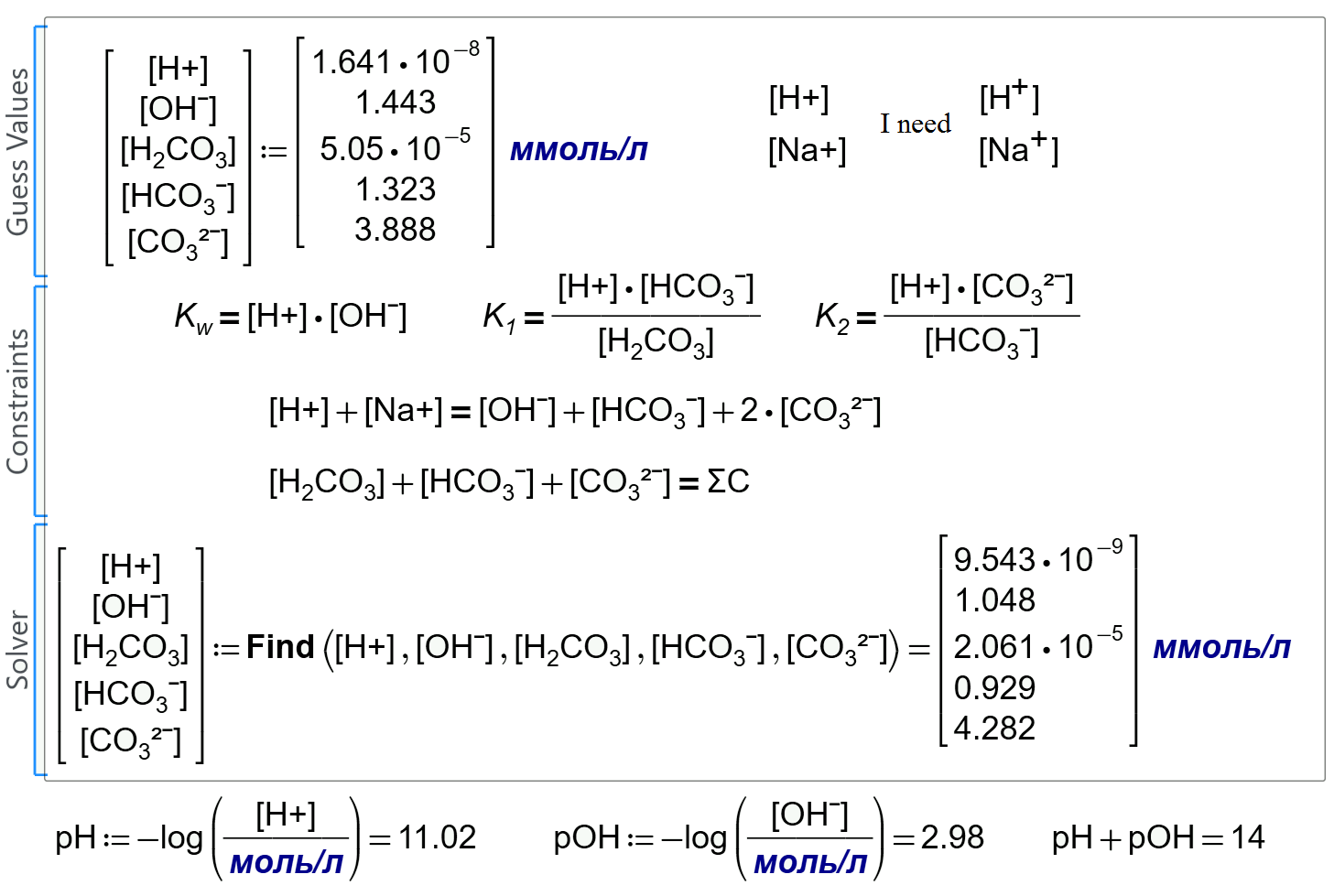

Plus as subscript
I can input - and 2- as subscripts.
But not +
I have not find + as superscript here
Solution?

June 11, 2017
Hmmmm....
Difficult to figure out an error from a picture.

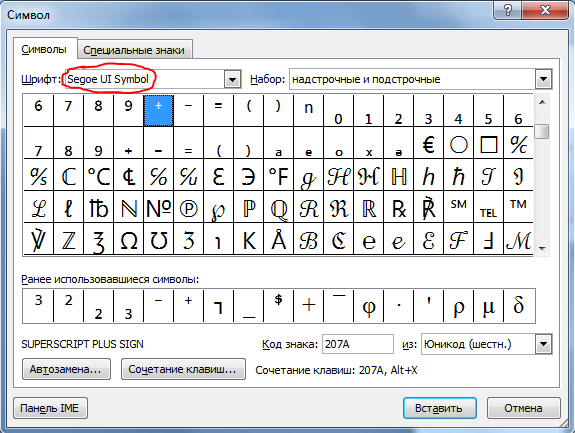

June 11, 2017
It is not an error! See please Prime 3.1 sheet in attach.
I am searching how to use a pluse sing as superscript!
June 11, 2017
You can find the superscript plus at: https://zeichen-zum-kopieren.de/hochgestelltes-plus-und-minus-mit-tastatur-schreiben-word-excel-und-powerpoint/
I revised your worksheet with this symbol.
To implement it you should do the following:
  1. copy it from website
  2. place your cursor to the place where you need it.
  3. type multiplication.
  4. paste the symbol.
  5. go back to the multiplication sign and delete it.
  6. Done.
Enjoy my friend.
