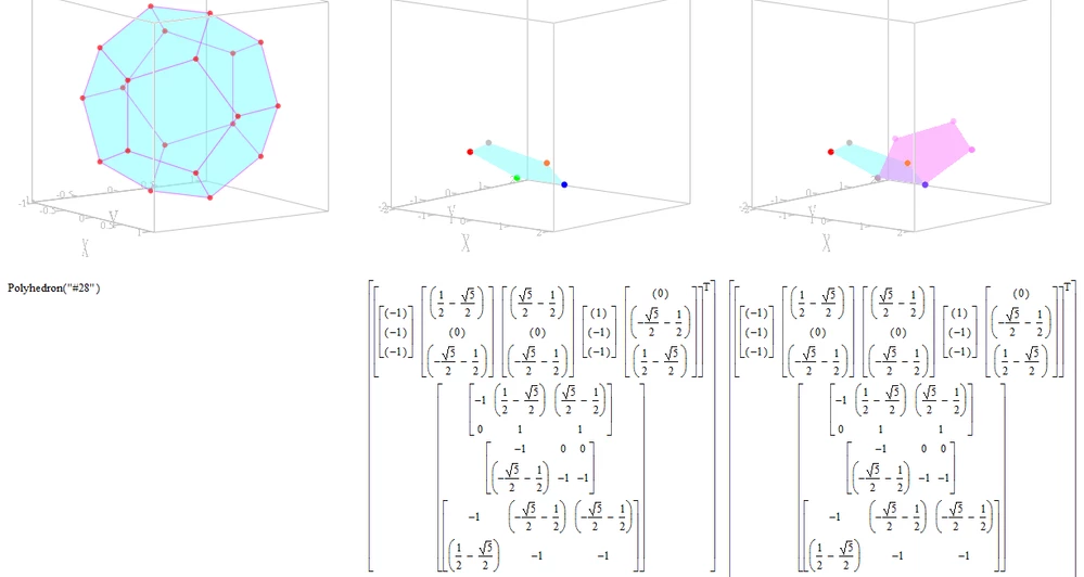

From the following:
Any idea to complete 12 faces of Polyhedron("28") ?

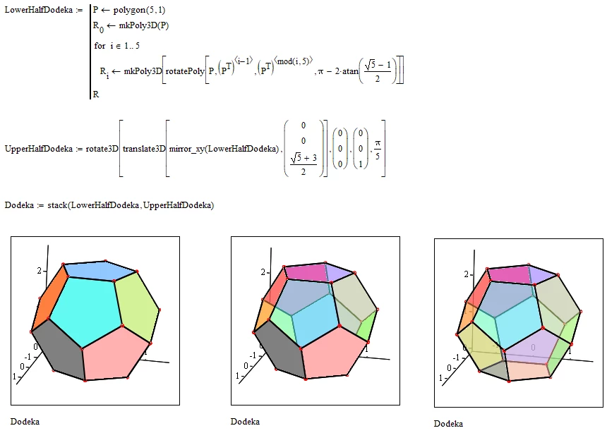

Here is a dodecahedron, not using the methods and functions in Prof. Birkelands great E-book:
The method used can be seen in the following animation:
Remark: Instead of mirroring at the xy-plane and then rotating by 36 degree it would as well be possible to rotate the bottom half around the y-axis by 180 degree.

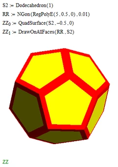

Prof. Birkeland also provides a function for drawing a dodecahedron. Here an example from chapter 4.13
But be warned - its sure heavy hardcore stuff 😉
