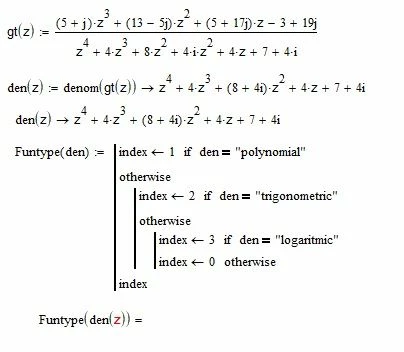

The function of the program should be something like this:
once the type has been identified, we pass to the transformation into a polynomial, if possible.

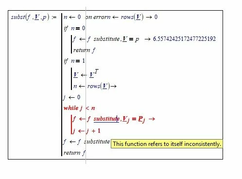

I got this far, so far:
I doubt whether this will (rather sure that this will not) work in Mathcad 15, but it does work in Mathcad 11.

September 5, 2019
Mathcad 15 returns this error:

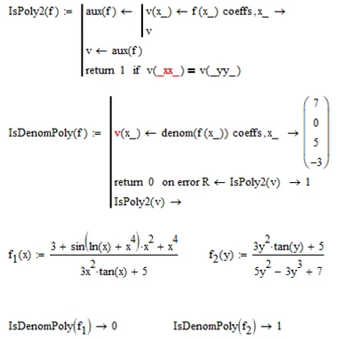

I am tempted to say that what you demand can't be done in Mathcad in a reasonable way as Mathcad does not provide the necessary tools.
Nonetheless here is a first attempt which may serve as a starting point for your own experiments.
There are a lot of drawbacks so far - you can only evaluate the function symbolically, its only working for functions in one variable and otherwise constants, ...
A few of the adverse effects could probably be corrected by some further investigations, but presumably not all. And I guess it will remain an uncertain, unreliable thing.

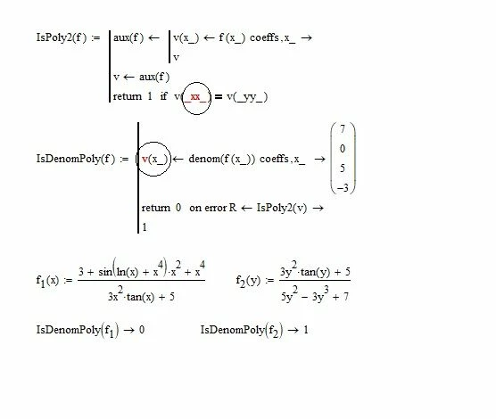

September 5, 2019
it would be better if the circled functions are not considered an error by mathcad. How to do?
September 5, 2019
I don't think there is a way.
You can switch off signalling of certain (types of) warnings.
You cannot switch off errors.
