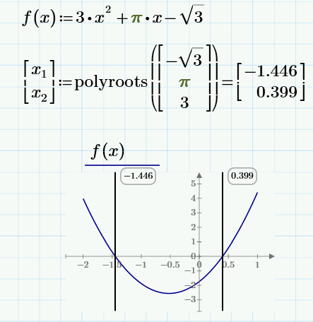

September 29, 2015
May be this help you!
Mathcad has numeric function polyroots:

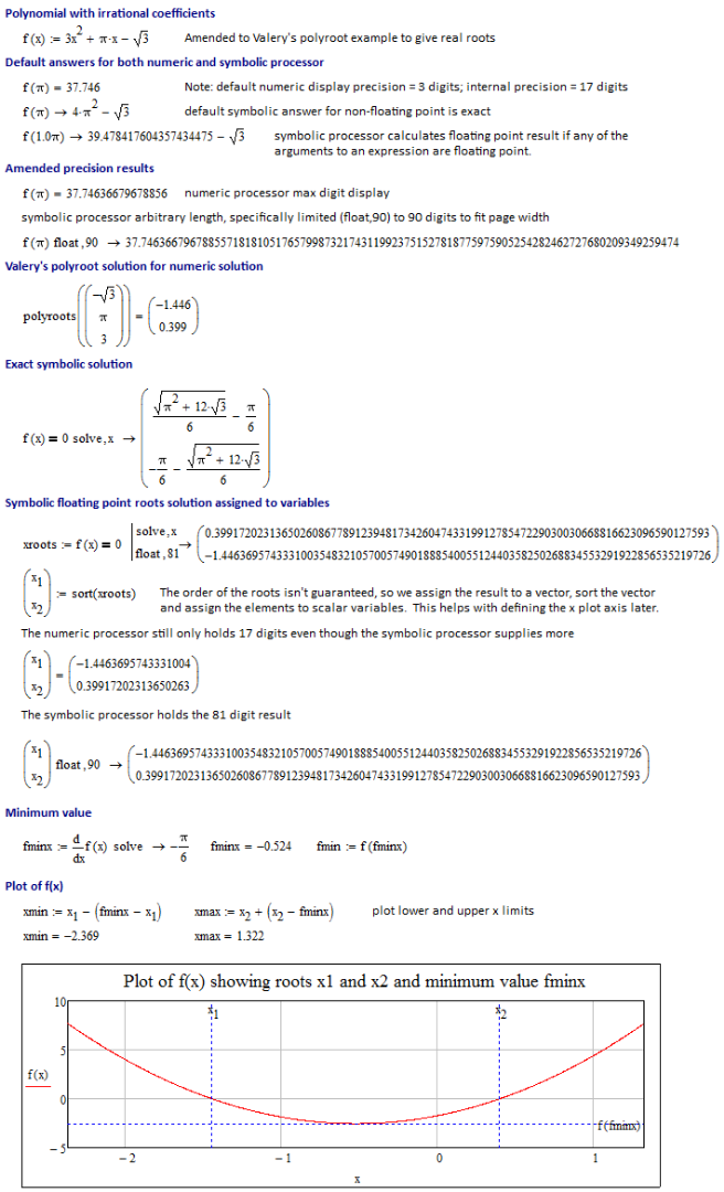

September 29, 2015
Must be синхронность in action, Valery!  I was just thinking about givin a symbolic solve for the polynomial.  I've changed the sign of my third term to match yours (to ensure real roots).
