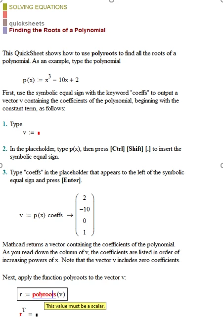

I get an error message trying to use polyroots: this value must be a scalar.
It seems to me, that the exact same error is also in the Quicksheet (see image).
Any hint would be appreciated.

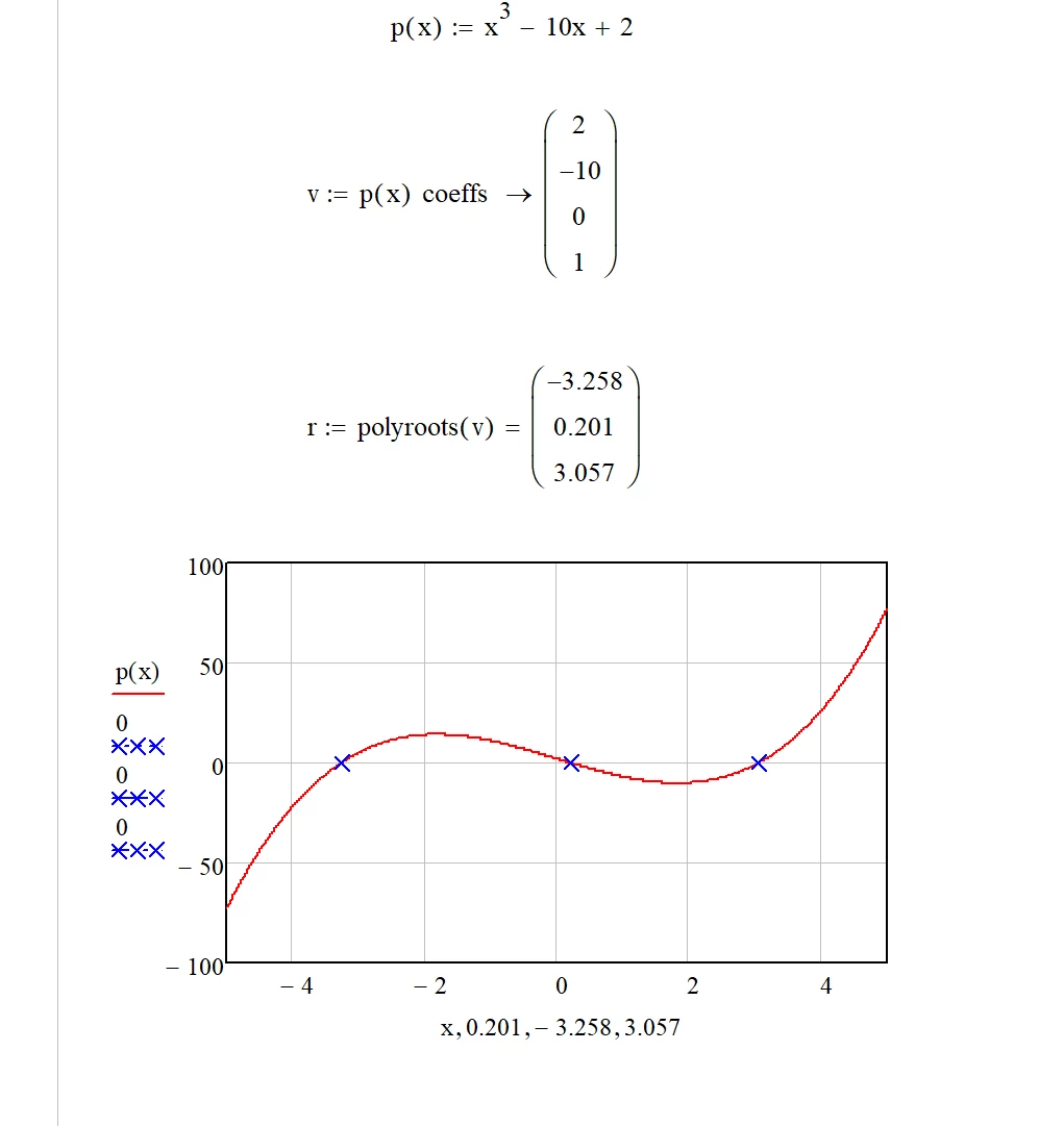

I would do it like this
regards
Owe

Feb 10, 2022 12:17 PM UTC
Thanks a lot Owe! it works now also in my case: so this would mean, the quicksheet is somehow wrong!

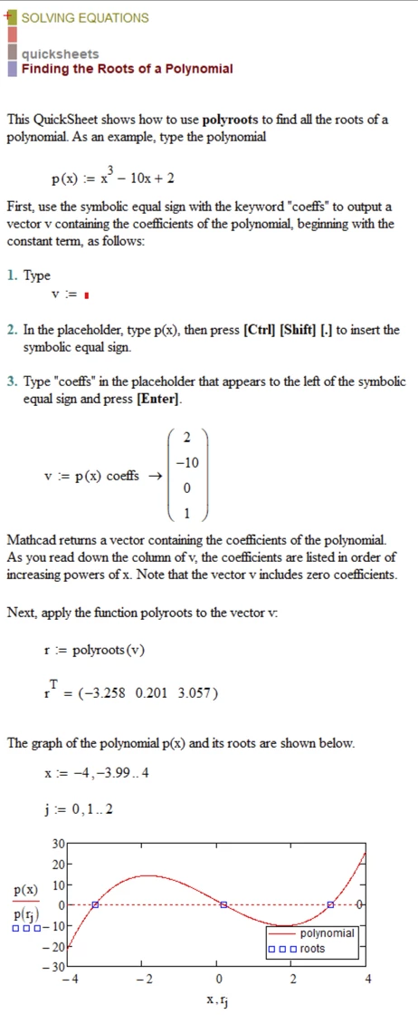

Feb 10, 2022 1:47 PM UTC
No, the quicksheet is not wrong and o.svahn has shown exactly whats in the quicksheet,
I am not sure what went wrong on your side, but when I open the quicksheet it works perfectly OK:
