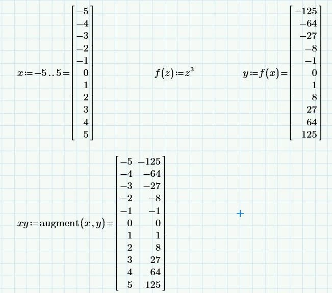

Hi all,
I'm new to Mathcad and trying to do somthing that is very simple on Excel, and hopefully isn't too difficult on Mathcad-
I have a range variable say z:=-5..5
I have a complicated function f(z), but for simplicity just assume it is - f(z):=z^3
I would like to have a matrix where the first column is z, and the second coloumn is f(z).
It should look something like that-
-5-125
-4-64
-3-27
-2-8
-1-1
00
11
28
327
464
5125
Any ideas/suggestions how to do it?
Thank you 🙂
terryhendicott
Jul 23, 2023 6:50 PM UTC
Welcome to the community
Like this
Cheers

OmerB1-VisitorAuthor
Jul 23, 2023 7:47 PM UTC
Perfect!
I knew it must be something simple....😅
Many thanks!
Omer
