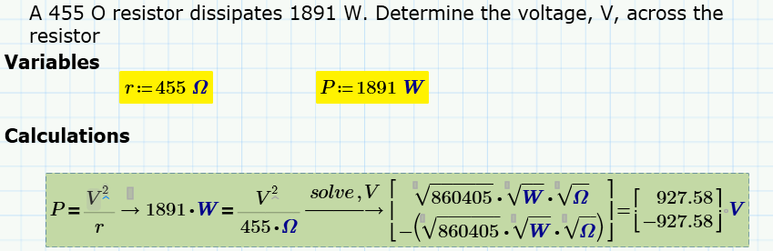

Hi
I get positive and negative result for my answer  which is understandable but I only want the positive result to display.
23-Emerald I
December 10, 2015
Don't use the symbolic solver (not because it gave you the wrong answer--because it gave you BOTH right answers.  Use your high school math to realize that V is the square root of P*r.  The square root function will only give you a positive value (or an imaginary number.)

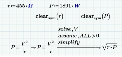

December 11, 2015
Use keyword assume:

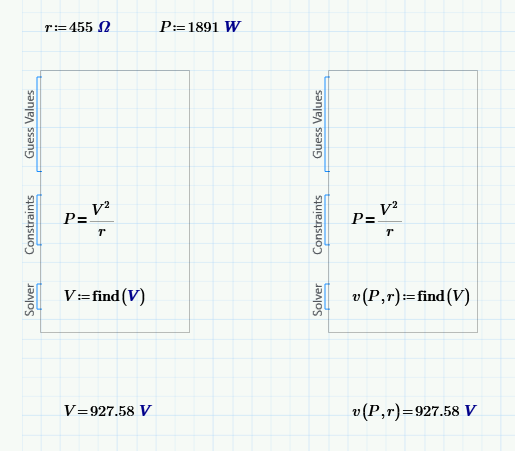

An alternative is to try a Solve Block instead of the symbolic processor.
The Solve Block (SB) on the left is a straight forward, one-off SB that returns the value of V for the pre-defined values of P and r.
The SB on the right uses a function definition to both pass P and r into the SB as arguments, and to return the value.
Stuart
