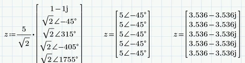

The way you define your complex number does not matter, as its the same number anyway and so it will also displayed the same way:

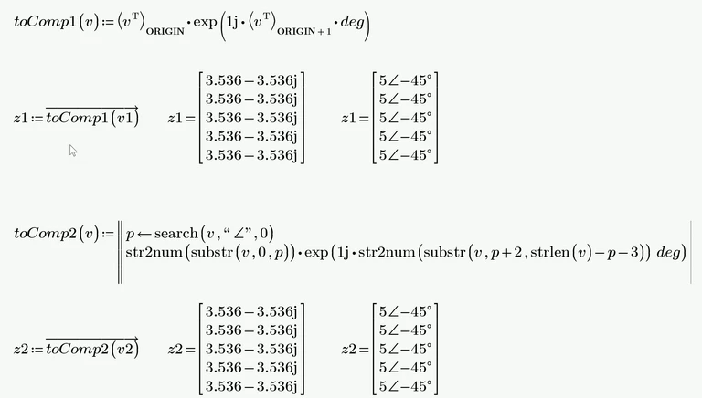

Of course you could write your own functions to display a complex number in a way which is similar
OR
but the results aren't numbers which you could use the normal way.
Sure you also could write functions to convert the displayed structure back to a normal number, but I would consider this all as to much hassle for every day work.
