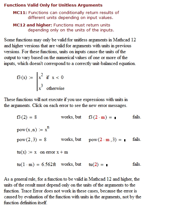

Might be worth reading this:
Sep 3, 2014 9:32 AM UTC
Good information, but I am not sure if it relates to the problem here.
After all without vectorization all is working as expected.
