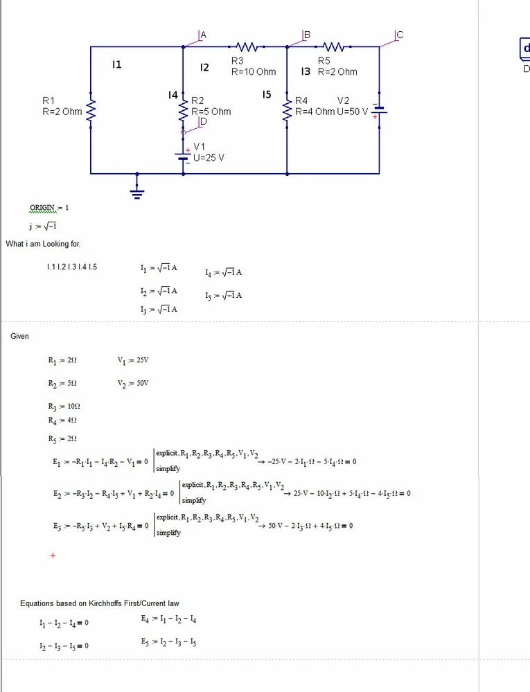

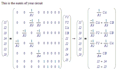

I am looking to make some symbolic equations then place them inside a matrix and solve current node mesh for the answer to circuit equation. I am looking for advice on how to do this or the advice that such an endeavor is impractical. My next goal is to find a PTC defined function to extract the coeffecient for the equations for Voltage and the unknown currents (I.1 I.2 I.3 I.4 I.5). So right as now i am looking to sort the result and THEN Store the results.

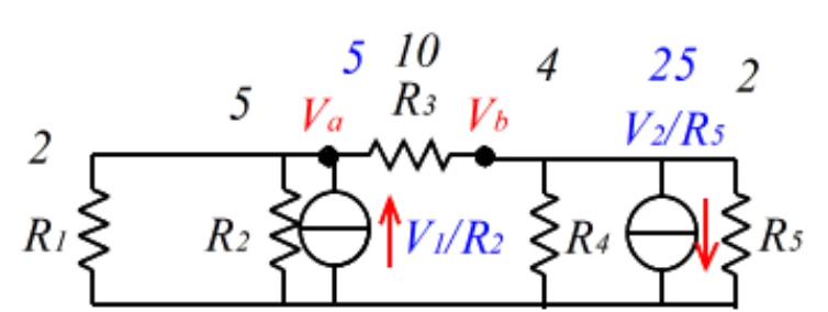

Is the attached the sort of thing you are looking for?
Alan

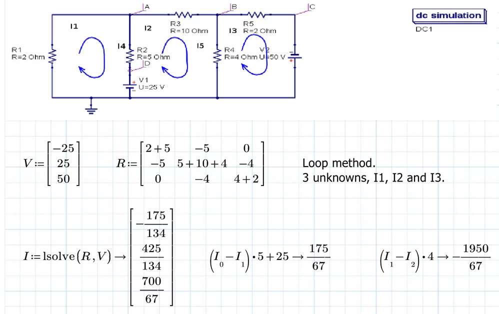

I am looking to organize the  equation (E.1, E.2, E.3, E.4, E.5).. I have five unknowns (I.1, I.2, I.3, I.4, I.5)  and the five equations already mentioned (E.1, E.2, E.3, E.4, E.5).  I want to organize the equation  in terms of  some number = an equation defined but the unknowns. I.E. (19=28*I.1+70*I.2+99*I.3-7453*I.4-972364*I.5) I then want to extract the coefficients. The place the coefficient into a matrix one equations at time till i have square matrix i can solve for. (I.E. invert roe escholon etc. etc low lever linear algebra.. if the matrix is not invertible i can throw and error?) I understand what your doing buy looking at the equations and just copying the equations into a matrix then solving for it. I am petty. i might want to do a simulation of passive components then run a script and some mathcad commands to check my other math cad work. I was working for a trainer and maybe went over board looking to use symbolics.

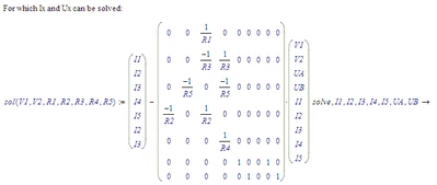

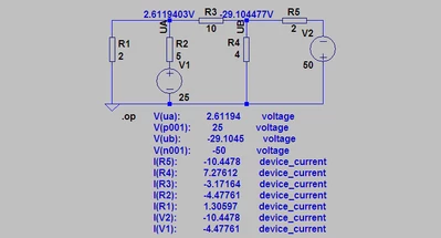

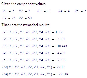

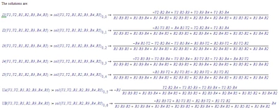

Hmmm, how about:
Check:

Some remarks:
The keyword "Given" to start a solve block must be written in a math region, not a text region
A solve block can also be evaluated symbolically.
See if the attached file helps

I can see your getting a solution. I can see you putting an initial value into the variable of the imaginary number square root of negative one i believe. I have to explain to the tutor/ friend why i am doing this in mathcad and how it gets me the answer i need. So i go back to what i know linear algebra and i try to make mathcad conform to formula i know. Your time is money.. Do you have any books to suggest that might explain this as i am probably more easily confused and have to be thorough in my explanation to my tutor?  (Worse i could (Henry David) Thoreau in my work which might be too wordy and too nerdy.)
