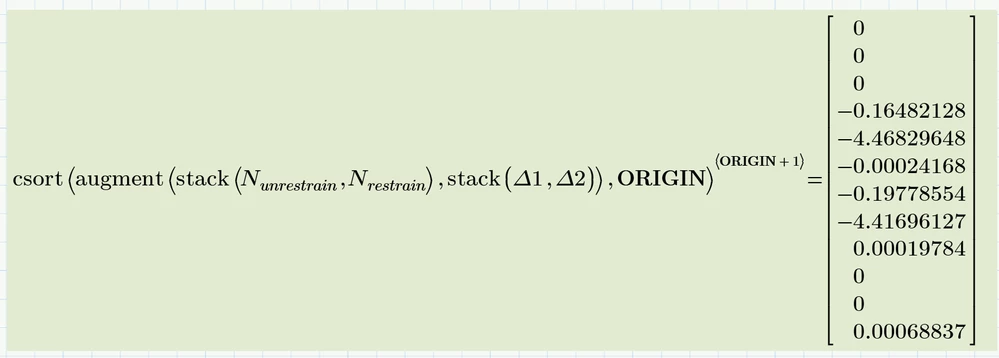

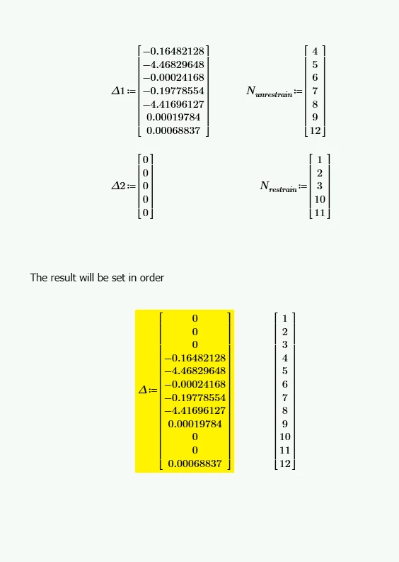

How about this:
P6 worksheet attached
EDIT: OH, I just see that Fred had already posted a very similar answer, using a couple of auxiliary variables for better clearness.
BTW, Freds approach assumes that ORIGIN has its default value 0. In your sheet ORIGIN is set to 1, so you will have to make some minor changes in using his solution.
