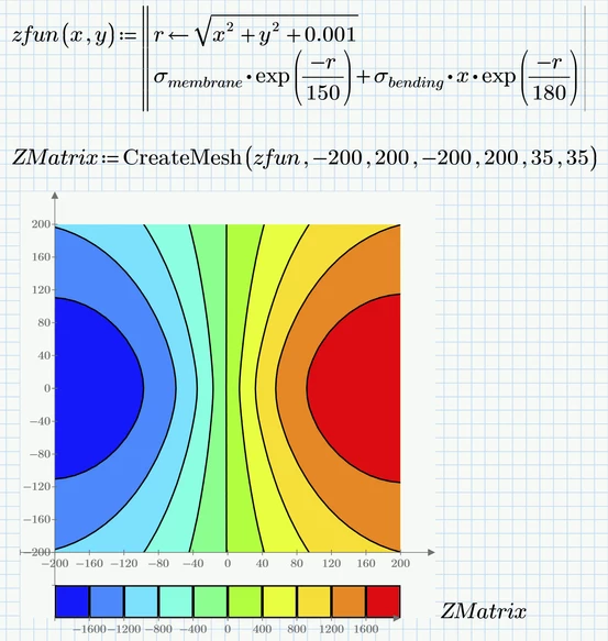

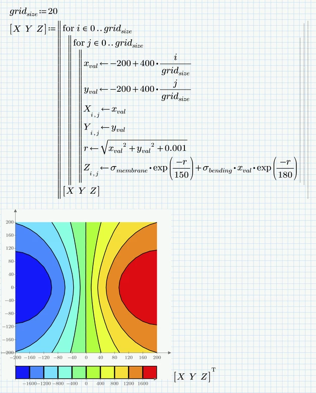

Werner_EAnswer
Dec 6, 2025 1:50 PM UTC
As I suspected, zipping doesn't help either, unfortunately.
Not sure what is going wrong here.
Actually you should not be able to send me an E-Mail as you should not be allowed to see my mail address in my profile.
But you could send a PM via the message system here inside the forum. If you did, it did not work as I didn't receive anything.

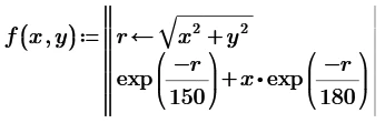

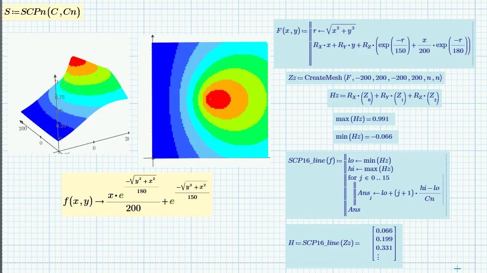

In the meantime I was curious and played around with the AI proposal.
I guess you are looking for that kind of plot:
On contrary to the AI proposal grid size 20 means in my approach to divide the range from -200 to 200 into 20 intervals and so we have a 21 x 21 matrix and not a 20 x 20 matrix is suggested by the AI.
May be a matter of personal preference or habit how to interpret the term "grid size".
EDIT: An easier way to create the plot is to define a function for the z-values depending on x an y and then use "CreateMesh" to create the necessary data structure:
BTW, is there a specific reason for the addition of 0.001 in the calculation of "r"?

Dec 6, 2025 9:42 AM UTC
What you show is not the content of a Prime sheet - maybe an AI generated text? Why do you expect it to work OK in Prime?
And where is your Prime sheet showing what you tried to do and  which errors you get.
Just two examples of wrong syntax:
// Create normalized thickness array
s ≔ 0, 0.05‥1.0
N_points ≔ length(s)
Can't work. If you do it that way, "s" would be a range, not an array.
You could create a vector using s:=vec(0,0.05,1) and to get the number of elements in this vector you could use   N_points:=rows(s)   but the suggested   N_points:=length(s)   would work equally well once s is created a vector and not as a range.
S_m_allow ≔ 118
S_L_allow ≔ 177
S_Pb_allow ≔ 177
y_Pm ≔ matrix(N_points, 1, S_m_allow)
Wrong syntax! The third argument of the "matrix" function must be a function in two arguments (representing the zero based matrix indices) and not a constant scalar as shown, You may use
As you say you experience problems implementing step 5, contour plot, I have to assume that you managed to implement steps 1 to 4 successfully. But the examples of wrong syntax which I showed above stem from step 3 and the variables created there are used to create the plot in step 4. So can we assume that you already have fixed the errors mentioned!?
Maybe you have troubles with another error in step 5 of this AI stuff:
 X[i,j] ≔ x_val
 Y[i,j] ≔ y_val
These assignments can't work. This is not how matrix elements are addressed!
In Prime you have to use matrix indices (not the literal subscripts !) when you assign values -  like   Xi,j:=x_val
I suggest that you come back here and attach the worksheet showing what you have done so far and which error(s) in implementing step 5 you experience.

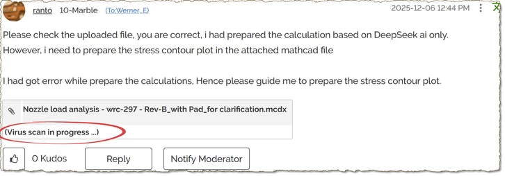

ranto11-GarnetAuthor
11-Garnet
Dec 6, 2025 11:44 AM UTC
Please check the uploaded file, you are correct, i had prepared the calculation based on DeepSeek ai only.
However, i need to prepare the stress contour plot in the attached mathcad file
I had got error while prepare the calculations, Hence please guide me to prepare the stress contour plot.
Dec 6, 2025 12:19 PM UTC
Unfortunately the file can't be opened because the Virus scan seems to run forever (its now already half an hour after you posted the file).
You posted at 12:44 and now its already 13:17 (my local time). An automatic virus scan sure can't take that much time.
Maybe you can try to post the file again, maybe a @PTCModerator  can help fixing this problem.

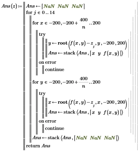

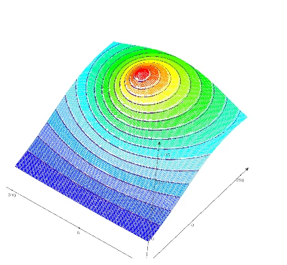

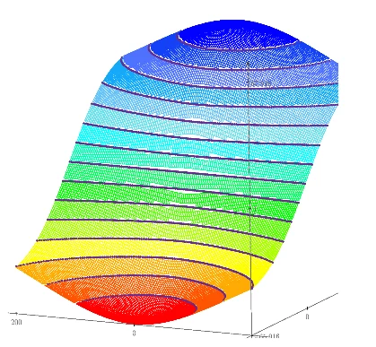

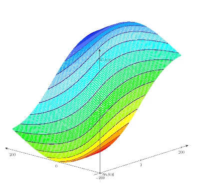

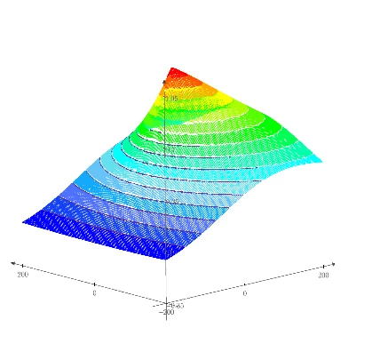

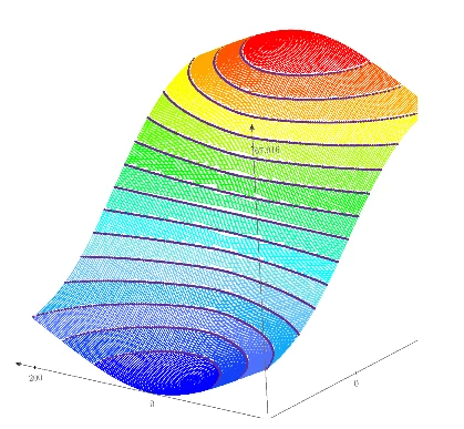

ttokoro
Dec 11, 2025 10:09 AM UTC

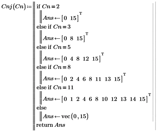

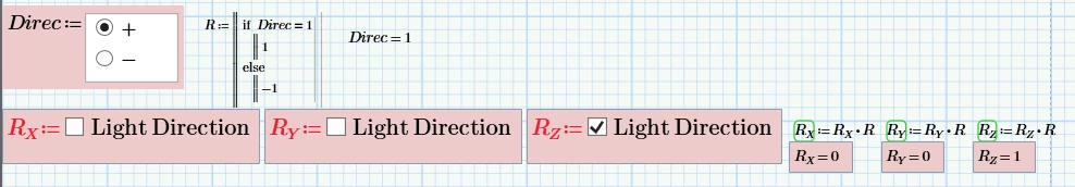

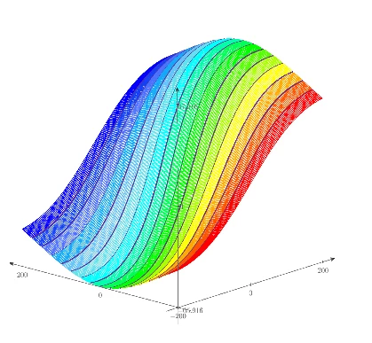

n:=150
z is a hight vector to make contour lines.
We can change the direction of hight not only z axis but -z or xyz etc.
Computer display shows white shadow but copy and past here, it shows no white shadow.
t.t.

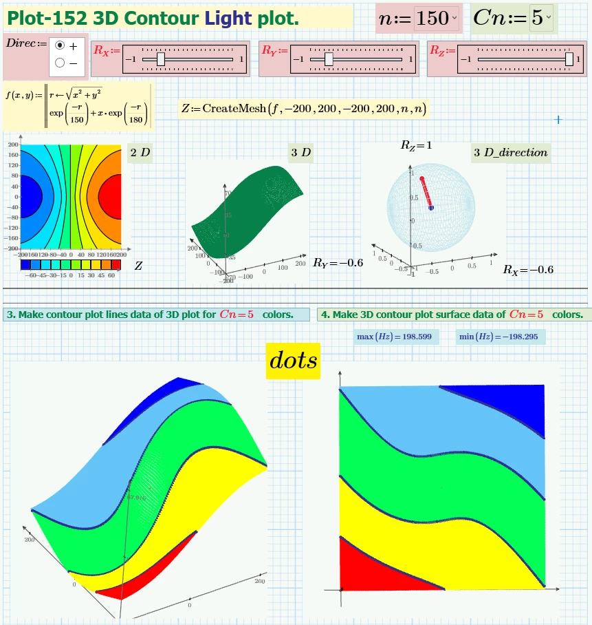

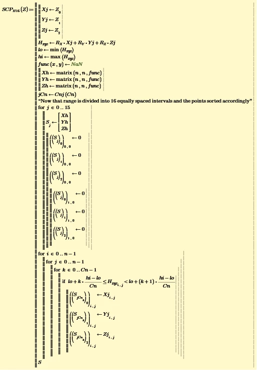

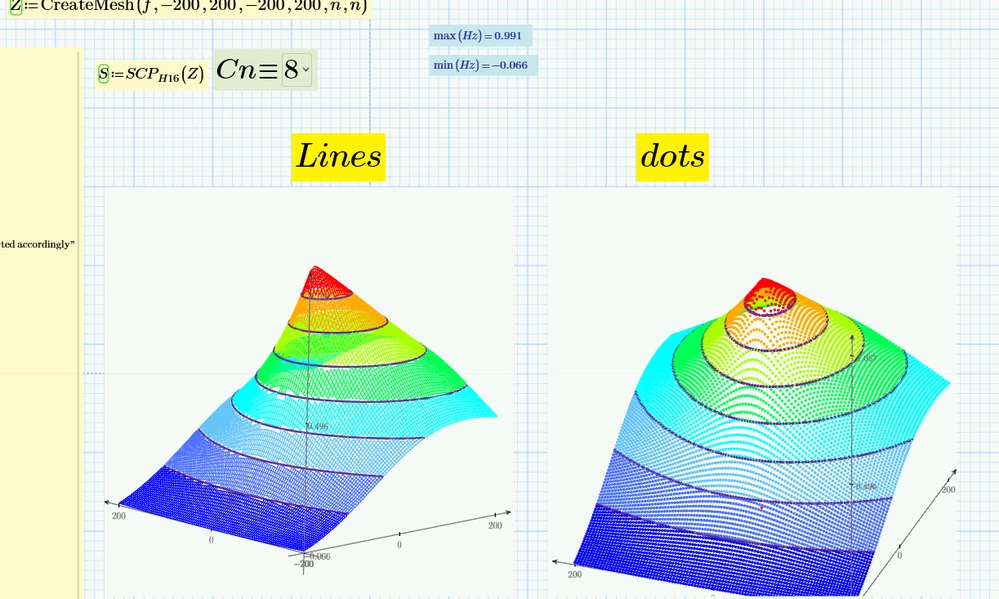

ttokoro

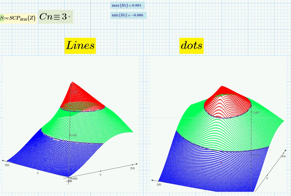

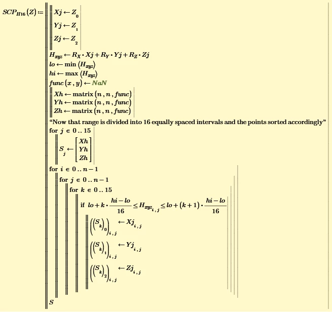

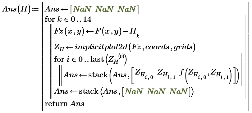

Dec 12, 2025 1:51 AM UTC
Make contour lines for colors bands.
Version up contour lines by using Program author: Viacheslav N. Mezentsev, 2006, Uni Home Lab, All rights reserved. Algorithm same as well as for implicitplot3d(), uploaded by Werner_E.
Now, number of colors can select by Cn vector.
t.t.

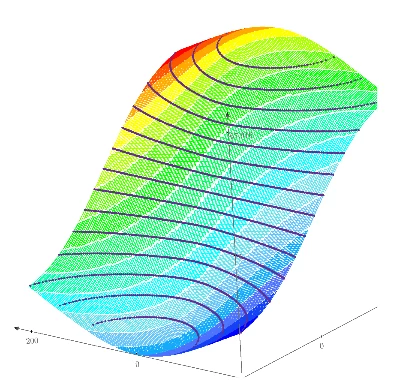

ttokoro
Dec 14, 2025 4:42 AM UTC
