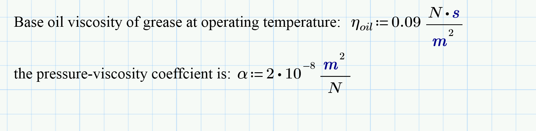

Does anybody know if there is a way I can put in the units of pressure-viscosity coeffcient which is [m^2 / N] in Mathcad Prime 3.0 ?
If I do it 'manually' they become some black and other blue. See picture.
Regards. Alexander J.
(I also uploaded the file I'm workin on)

Hello, you redefined "N" as 20*rpm. "N" is a predefined unit already in MC.
Define "your N" with a subscript and the unit you are looking for will become blue.
I hope this helps.
Norm

Hello again
This sorted things out. Thanks!
