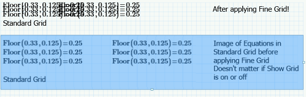

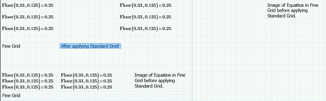

What is the rationale for the change in region position on the page when changing from Standard Grid to Fine Grid and vice versa?  I don't mind the change in granularity, but I don't want my regions to jump all over the place when I change the grid size.

I don't know about Prime 3.1 but the problem persists in 6.0.  Inelegant but simple work around:
  • <Ctrl-A>  Select All
  • <Ctrl-X> Cut
  • Change Grid Size
  • <Ctrl-V> Paste
When pasting, it seems to past at page coordinate location rather than grid location.
