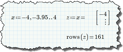

In Mathcad 15, if I want to convert a non-integer range variable to a vector, I can use several techniques, including this:
However, in Prime 3.1 all I get is this:
I want to complain!

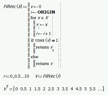

Seems like the internal loops are now implemented differently.
Some other of the old and dirty tricks still work, like the assignment with in-line evaluation:

October 19, 2015
This at least still works:
You do have to define the range variable though, because it won't let you pass a range value as an argument (why?).

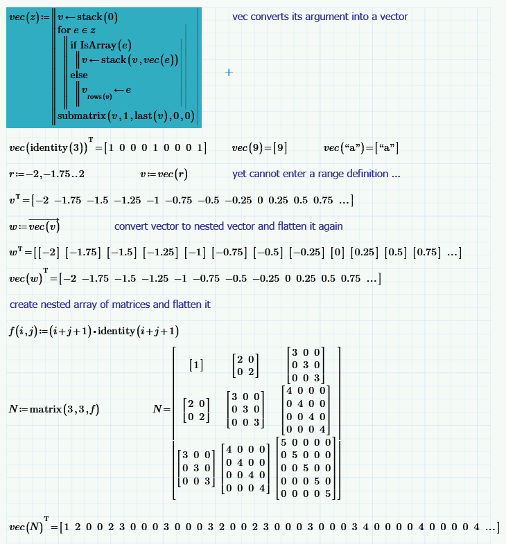

As does my vec function ... thankfully,
Tell me about it, already.   I pointed this out years ago ... Re: Convert Nested Array to Matrix
