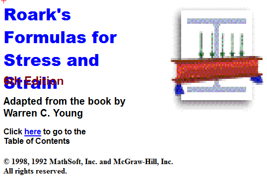

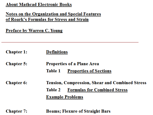

I have not seen the Roark's workbooks to know what to expect.  I was hoping they would be quite useful, but I am sensing from your post that may not be the case.  Is there anywhere to see what the layout of one of the workbooks is?  I'm thinking a screenshot or something at least would be nice before dropping that much money for the sheets.

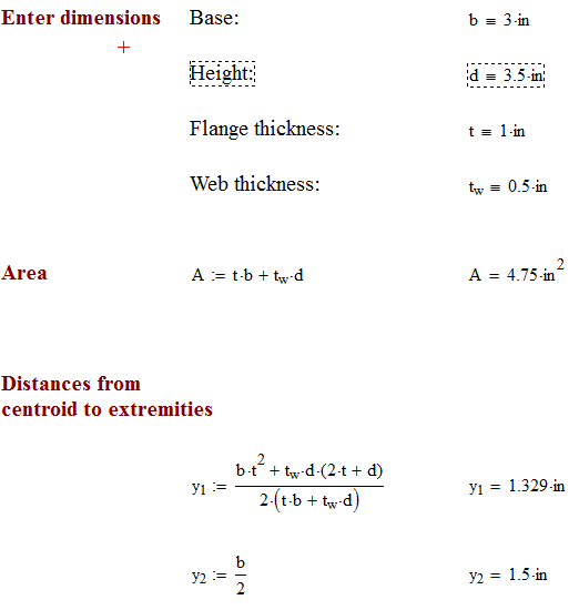

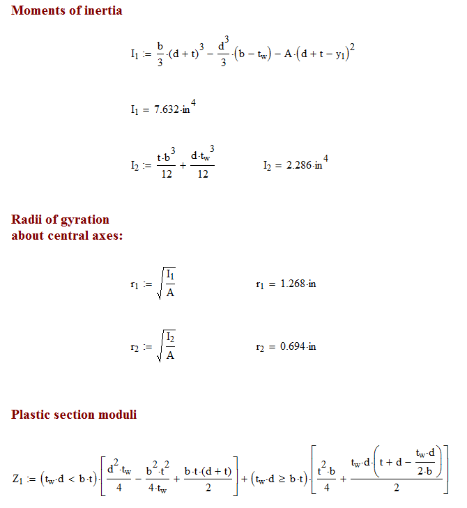

From Mathcad 15 version:
The files are set up so you input your values (the three-legged equals is a global definition)
And the sheet calculates values for that case.  No functions are defined--if you want to investigate a sensitivity you will need to create the function.  The only real benefit is that the expressions are already written and are (almost always) correct.
