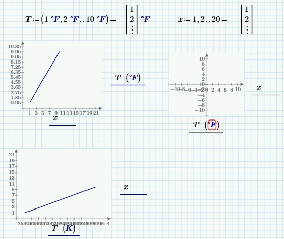

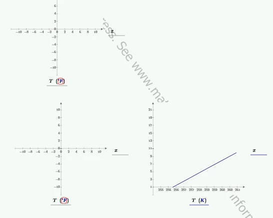

This seems to be a bug.  Prime 7 won't plot degree C or F on the x-axis of a plot.  (Kelvin and Rankine work fine).  And degree C/F seem to work fine on the y-axis.  (I know degrees are technically functions and not units in mathcad, but this worked in version 4.  )  Is this a bug or a quirk?  any workaround (besides using absolute temp - which isn't very practical)
Prime 4 file attached.  open in 5-7 and refresh and you should see the error.

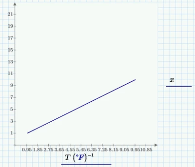

PTC provided a workaround for now.  But should be fixed in 8.0
To enter the equation do the following:
Type T
Add the Scaling operator (Ctrl-Shift-u) or via operators menu
Add Parenthesis (Note:  DO NOT use the unit parenthesis that are in the plot)
Add degree F unit from Units menu
Add -1 exponent
Should look like this: (Note little dot after T and the exponent is located lower than normal.

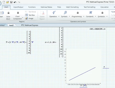

Don't see the problem. Opened your file with Prime 7:
23-Emerald V
Oct 8, 2021 8:36 PM UTC
Did you Calculate the worksheet?
I saw the problem in Express 7, even when I created a new Plot.

Yeah,  forgot to re-calculate.
Now I can confirm it's OK in Prime 4, broken as of Prime 5.
