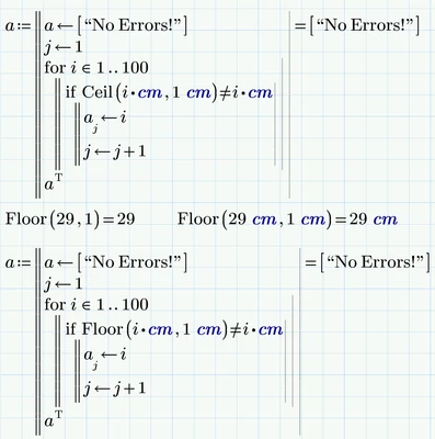

Hello everyone,

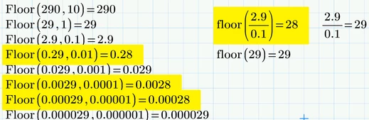

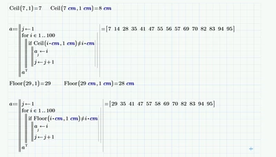

I am experiencing the same rounding error from previous versions in Mathcad Prime 6.0. Have an explanation?  Or, where can I report effectively this error?

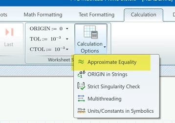

The solution is simple.
Check "Approximate Equality" ("Calculation" ribbon, "Calculation Options") and you should get the correct result:

BTW, AFAIR this bug has already been reported here in the forum a few times (its also present in real Mathcad, so its rather old)  and also shows up without using units:

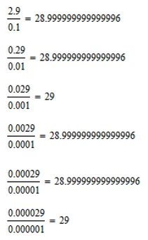

BTW, in MC15 we can set the number of decimal places to 17 and that way we can see whats happening. This at least partially explains the effect - internal round-off errors - possibly due to conversion from decimal in IEEE binary format. The effect also shows if we set the result to 15 decimal numbers. If we do that in Prime (15 is the max possible here), we are not shown that round-off error but obviously its there as we still have the bug in "floor" etc.

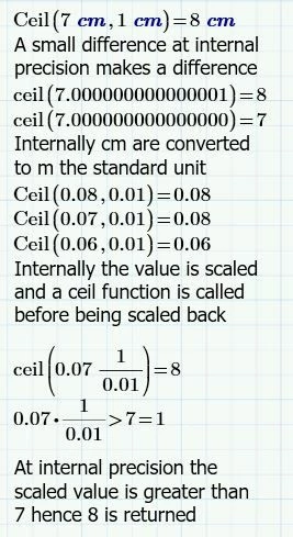

It is not really a bug, but a matter of internal precision representation of 0.07 / 0.01 being greater than 7.0000000000000000.

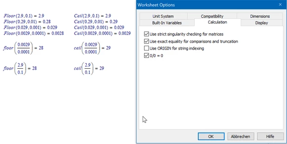

It gets even more crazy!

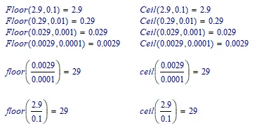

I open the MC11 file which Luc had attached and opened it with MC15.
As you can see in the screen shot - all calculations are correct now!
Even if I retype from scratch one of the expressions which formerly gave a wrong result, the result now is correct!!
When I open an new sheet and copy the region with the correct result from Luc's sheet to the new one, I get the wrong result again.
My test expression was floor(2.9/0.1) which gives 29 in Luc's sheet and 28 in a sheet created with MC15.
I also saved Luc's sheet with MC15 in xmcdz format and then reloaded it, but the results still are correct!

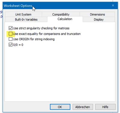

EDIT: Found it!! Silly me - I really should have thought on that from the very beginning!

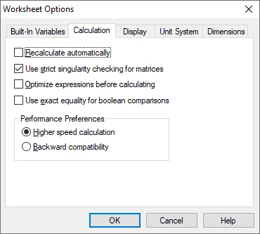

In real Mathcad one can influence the calculation behavior and in Lucs Sheet in the Worksheet Options the option "Use exact equality for comparison and truncation" was unchecked, while in my sheet this by default was checked.
Unchecking this options makes sense, I guess.
23-Emerald V
Mathcad 11 gives me these options:
The setting that comes closest to Mathcad 15's "Use exact equality for comparison and truncation"  is the last box: "Use exact equality foor boolean comparisons"
Of course I've tried it. There's no difference in any of the results. Checked or unchecked, I get:
I've saved the file now with the box checked. Please check how it translates to Mathcad 15..
Here is what I see when I open your new sheet.
The box is still checked and some results of course are wrong. Unchecking the box talks Mathcad into delivering correct results.
Alvaro_951-VisitorAuthor
Very helpful! Thank you Werner. This at least hide the precision error from Mathcad.
