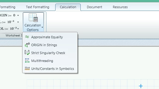

I am using PTC Mathacad Prime 6.0 student version for my civil engeneering procjet but after while about 2-3 hours program starts to lagging. Even adding new variable takes few seconds. The file is not big 127 KB and has 23 pages. When I restart my laptop everything is ok for next 2-3 hours. Any sollution?
December 7, 2019
Try to turn off "Multithreading":
1. Go to "Calculation" tab --> "Calculation Options" button.
2. Click on the "Multithreading" button.
December 10, 2019
I don’t have any issues with large matched files in prime 6. Works very well. The multi thread option is very useful to keep on as it allows you to continue editing working on a mathcad sheet instead of it hanging and having to wait until the calculation is finished. Multi threading is a big improvement on V15.
