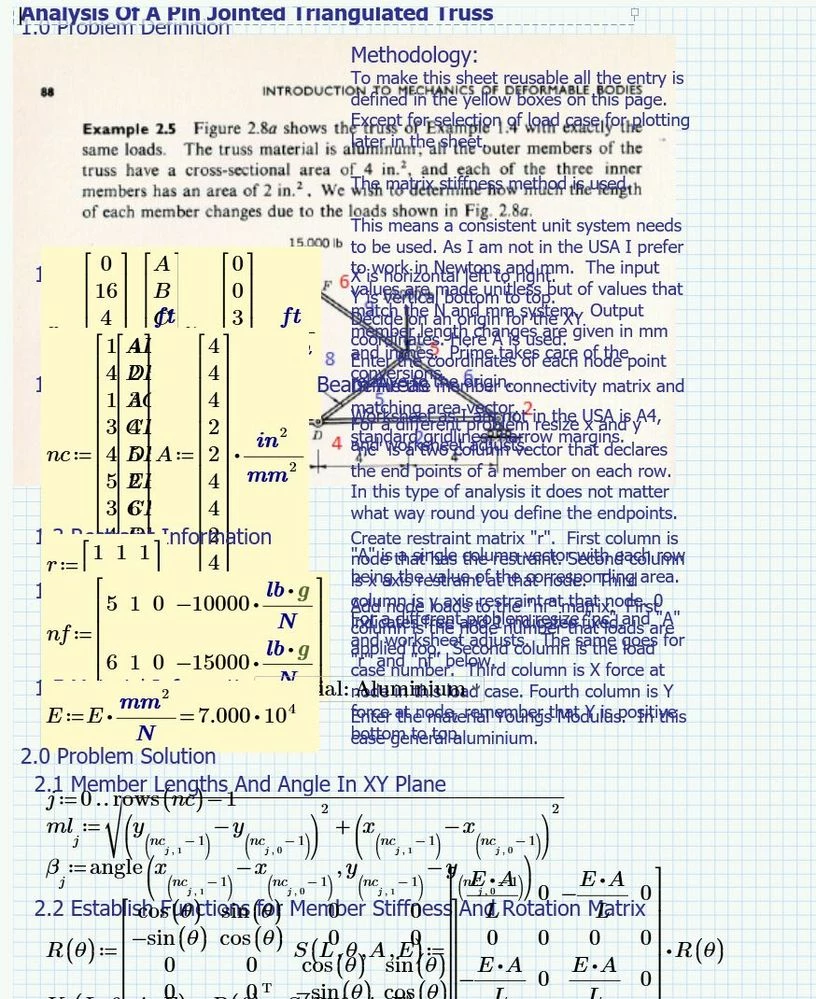

I am using Prime 7.0.0.0 with Windows 10 Pro.
When documenting my I generally put a small math region declaring and defining a variable/parameter on the left and a text region/block on the right describing the variable/parameter.  I generally have several of these one after another.
When I save the document the regions get rearranged.  Regions are moved towards the top of the page so that they overlap previous regions.   This mostly happens early in the document - mostly on the first page but sometimes extending into the second page.

Hi Robert.
Document made with gridline standard then changed to gridline fine.  Luckily when changed to gridline standard it comes back.

While continuing to work with this document I noticed that as I edited text blocks several pages down in the document regions on the first page were getting overlapped.  I noticed this as math and text were now moving across a page boundary.  An undo of the edit restored the first page.  This is most unusual behavior.

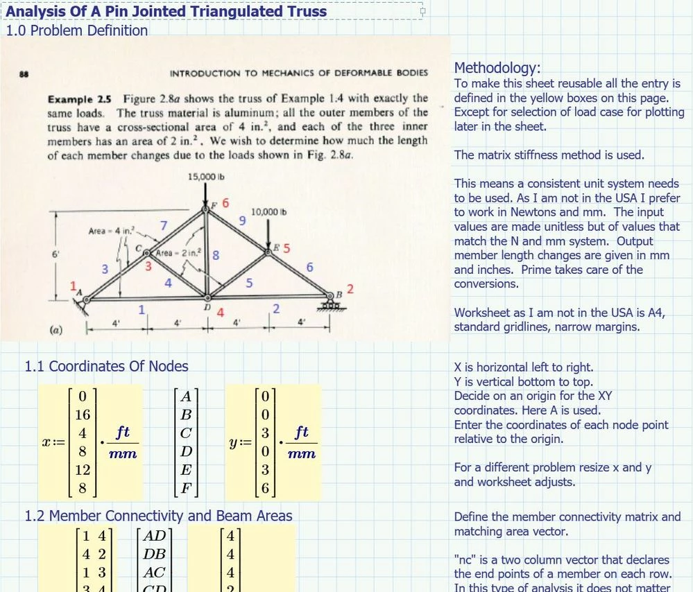

Attached is an example of one of my calc sheets formatted this way.
I hope this helps!

I have a similar problem about the general functionality of the grid spacing.  When a worksheet is started in either fine or standard grid spacing and then you change the grid spacing, all the regions throughout the entire worksheet scramble everywhere!  I do not understand at all why changing the grid spacing scrambles all regions; quite frankly, it is ridiculous functionality and should not happen.  I'll never create another worksheet in standard grid spacing.  I hope PTC fixes this scrambling when changing the grid spacing.
March 31, 2022
While your problem seems not to be related with the original posters problem, I agree that this is a very annoying behaviour and should be changed to something making more sense.
The reason for the effect seems to be that the position of regions are stored in grid coordinates and so when you change the grid you also change the position on the page, which is quite silly.
If the worksheet is not too large, a workaround is to select and cut all regions (Ctrl-A, Ctrl-X), then change the grid and after that reinsert the regions (Ctrl-V).
I would expect problems with large worksheets so use at your own risk and don't forget about a backup!
