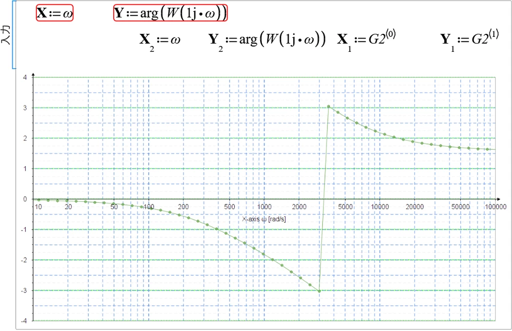

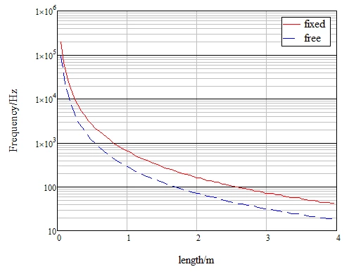

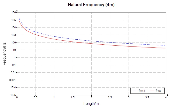

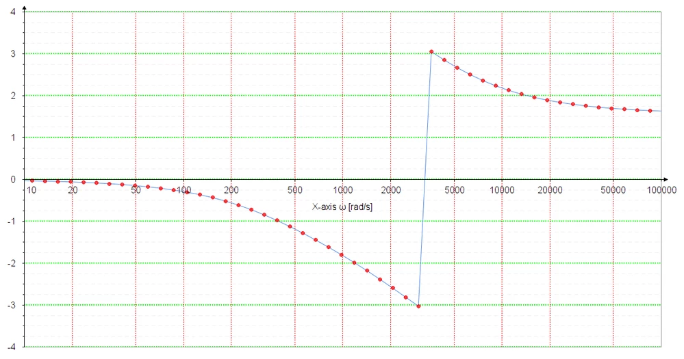

  • what irks me most is that logarithmic scaling is not displayed properly. The numbers on the axis are correct, but the axis representation is not. See attached images.
