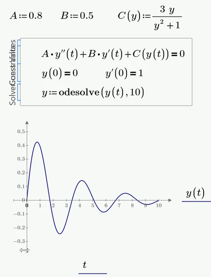

"odesolve" works with A*y''(t) + B*y'(t) + 3*y(t) / (y(t)² + 1) = 0 but it doesn't work with the substitution term
C(y(t)) = 3*y(t) / (y(t)² + 1)
A*y''(t) + B*y'(t) + C(y(t)) = 0
I tried in several ways to define C, e.g.  C:= 3*y(t) / (y(t)² + 1); C(t, y) = 3*y(t) / (y(t)² + 1) ... etc, but in vain!
I am attaching my file to this post and would appreciate your help very much !
Thank you in advance, Peter

Haven't yet installed Prime 7 and so I can't open your sheet.
Can it be that you are looking for something like this?

Dear Werner,
Thank you so much for your valuable help!
I fixed my sheet and extended the content. Now, it works without units.
First, I tried to reproduce an example from the old Biggs' book. Key scalar results look pretty good.
However, the form of the time-dependent deflection curve is quite different: after the first peak the next minima are much smaller compared to my results. I guess, this is to be attributed to energy dissipation...
Anyway, there is some bug that I could not figure out yet ... or "odesolve" doesn't  provide correct results.
Maybe I should try to improve the integration time step ... have to figure it out how to do it....
Next, I introduced the units and it doesn't work! I couldn't figure out the reason for this as well.
I was not aware of the compatibility issues between P7 and older versions. I am providing my results, for those who are interested to use the sheet. But still have to do some homework... 🙂
Best wishes, Peter
