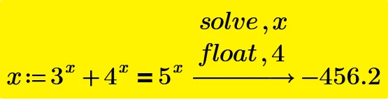

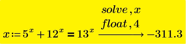

Prime 7 symbolic bug of solve
Are these symbolic bugs of solve of Prime 7?
I want to have the answers as x=2.
Understandable. but obviously this means that you must use a different software (Maple, Mathematica, real Mathcad up to MC15 or even Prime up to P6) and maybe wait and hope that the symbolic engine gets improved.
Which results do you get in P7 when you evaluate the left and right hand terms using the suggested value of x?
Here the results of MC15 with muPad:
