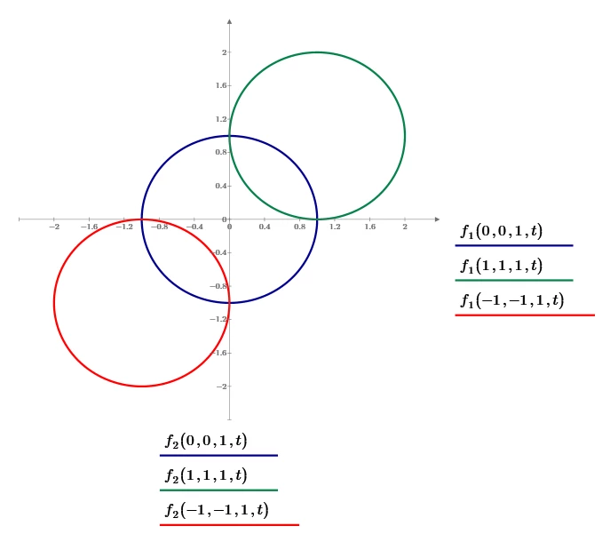

How can I plot a circle in the X-Y plane, only knowing the radius and location of the circle center?
I have Mathcad Prime 8.0.

Thank you!  That was easy.

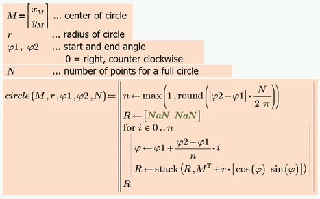

Here is a circle function I often use when I have to draw a circle.
You may use it to draw partial circles

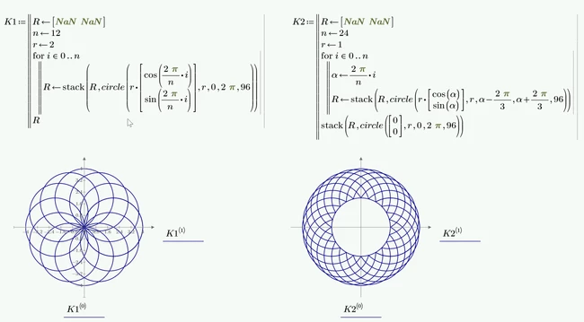

to draw regular polygons
or to play around and create mandala like pics
Prime 9 worksheet attached

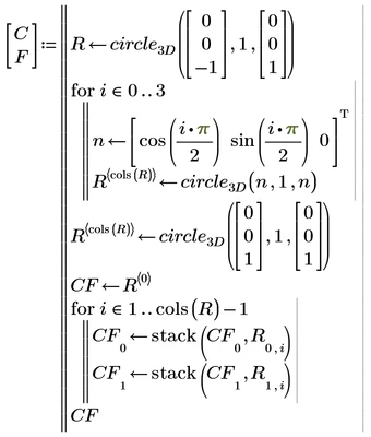

Nice, but why only circles parallel to the xy-plane?

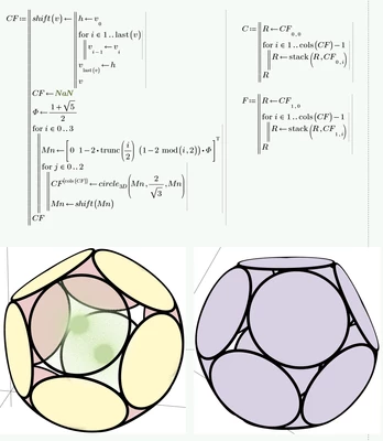

Playing around with the inscribed circles of the surfaces of a dodecahedron
