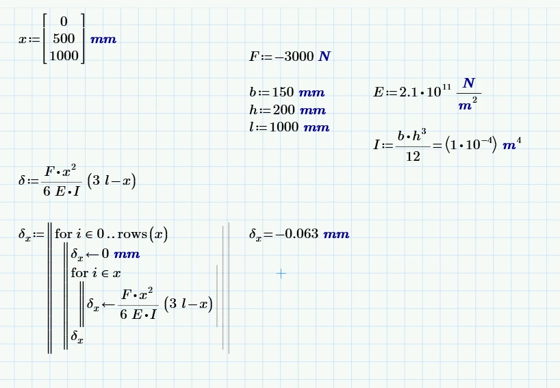

Hello, I am inputting a vector into a for loop, but struggling to get a vector back for the output.  I would appreciate any help.  I could not figure it out from other examples on this forum.  I am wondering if I am making an error in the initial step of the for loop?
Thank you.

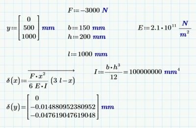

Here's what Luc is saying put into practice. You don't need a program, you can just have a vectorised function definition.

1. You should attach your Prime Worksheet.
2. Your program for delta.x uses i in the for loop, but you are not using i in the index of the vector. This means your program does not create a vector.
3. I think that if you vectorise the expression after
delta :=
Then delta will be the vector you are looking for, and you don't even need the program for delta.x

DJNewman and Luc, thank you so much!  DJ, I appreciate you putting up the image.  Sorry for not including the worksheet, I will definitely do so in the future!
