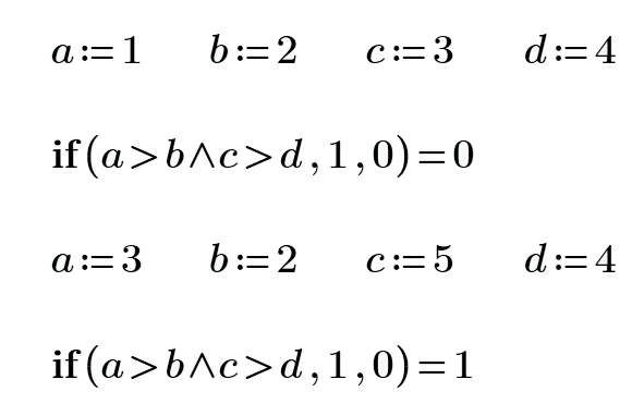

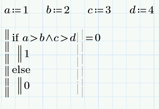

Better - in Mathcad 15, Mathcad Prime and Mathcad Express:
NovaStark4-ParticipantAuthor
January 24, 2016
It works now.
Didn't know that the second logic statement existed!
Thanks again.
