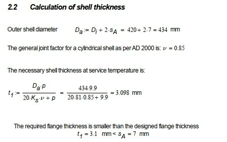

Prime is ideal for my technical documentation (example attached),
I don't need any other program, i.e. no Microsoft products (Word, Excel...).

Here is a counter-example of Mathcad 15.
Not only does is look neater (see attached image), but I could make the textbox at the end change colours and text if a given threshold was exceeded. This came in very handy when checking long calculation documents.. This isn't possible anymore in MC prime.
