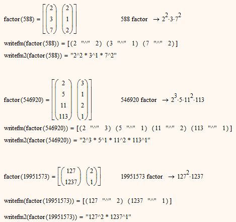

Hello Everyone,
Now I need help with creating a function with the output like as the following ( or a similar ) :
Thanks in advance for your time and help.

Dec 22, 2014 6:27 PM UTC
Here you are.
A quick hack - neither short, nor elegant, nor efficient. But it does what you have asked for.
With all limitations numeric calculation has to offer.

lvl10720-TurquoiseAuthor
20-Turquoise
Dec 23, 2014 2:15 AM UTC
Many, many thank, I greatly appreciate your help, Werner. .
