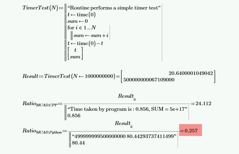

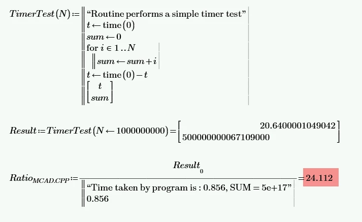

Good morning,
I am running some deeper simulations in P8 and noted that the CPU grind was pretty fast. I was surprised at this and ran a simple side-by-side with compiled C on a simple summation test.  I found that the slowdown ratio was only about x25.  In similar tests, I have found Python to be about x200 to x500.  I'd be interested to know how P8 has achieved this.  Perhaps the developers could comment.MCAD Posting CPU Grind.png
Here is the C++ project

I went back and did a comparable Python test which shows Python is about x4 slower than P8:
Here is the Python code:
import time
t_STR = time.time()
SUM = 0
N = 1000000000
for i in range(N):
 SUM += i
dt_CPU = time.time()- t_STR
print(SUM, dt_CPU)
Results:
Regards

@DS_10314450 wrote:
Good morning,
I suspect that there may be an assumption in your thread title.
I'm not a developer, but I suspect that Prime 8 (and earlier versions plus Mathcad 12 onwards) don't use a direct Mathcad interpreter.
Instead, I think that they compile the worksheet to an intermediate, and partially optimised, code that itself is either interpreted or compiled.    I believe that Mathcad 12..15 compiled down to the Mathcad Programming Language (MPL), which looked awfully like Haskell.
I vaguely recall there being some hints that the MPL definition would be firmed up and users given the ability to write MPL code that Mathcad would pick up at load time or access via a component or be able to be used in "programming" constructs.   Nothing came of this, however.
Stuart
