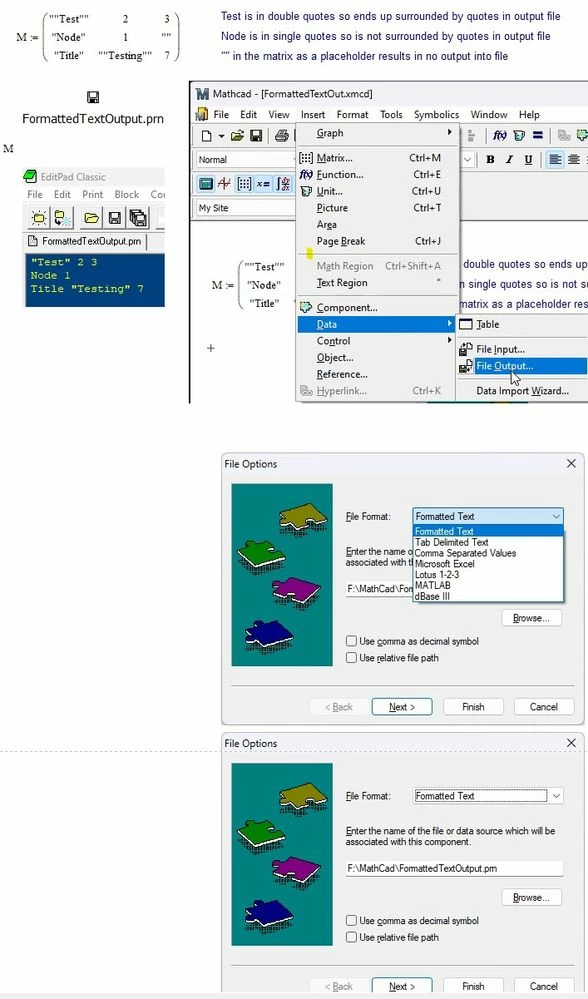

First what was possible in Mathcad 15
Mathcad 15 had a data file export component.
This data file export component when you selected "Formatted Text" did four things
1) Text in double quotes ended up in text file with single quotes
2) Text in single quotes lost the quotes in the text file
3) Adjacent quotes "" to indicate no data did not appear in the text file.
4) Numbers stayed as numbers
In this way a very large text file could be generated from a Mathcad matrix quickly
Here is a simple example.
Primes current file output functions cannot duplicate this Mathcad 15 data components behavior.

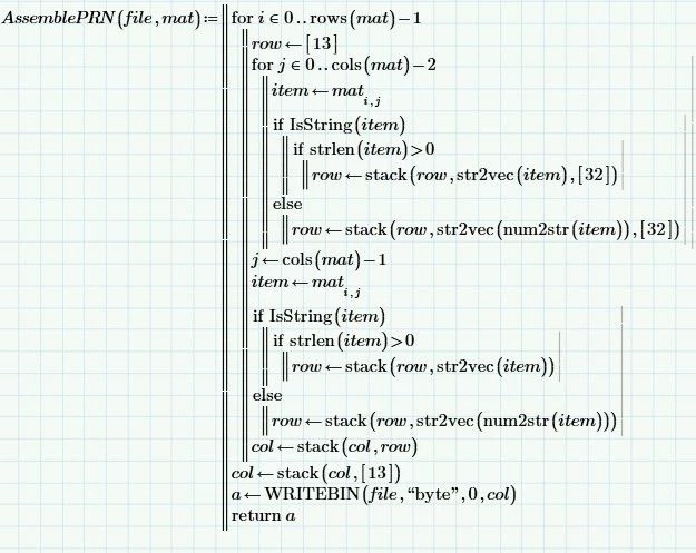

I created a function that uses str2vec to create a giant column vector of ascii characters, but it is agonizingly slow.
For instance a Prime file with a matrix of 99514 rows x 8 columns with 4.5 million characters takes about half an hour in Prime to calculate and save the large column vector.  The vector is saved by WRITEBIN function.  Half an hour for hundreds of parametric files is a long time I am not looking forward to.  Hence my call for help.
Can anyone speed up the function or suggest a faster method of creating the file in Prime.

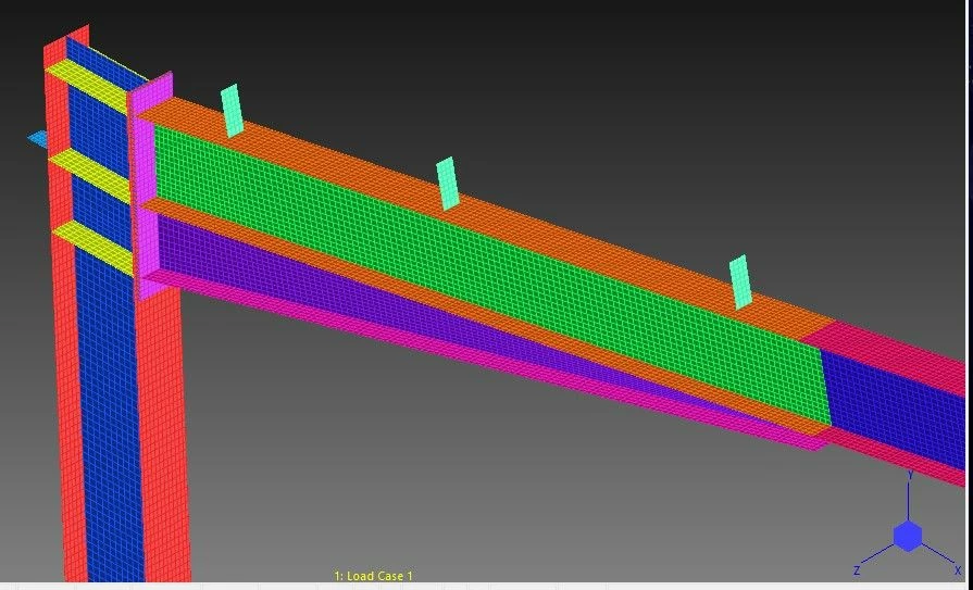

This is what the finished finite element model looks like generated from a few parameters using Prime.
My aim is to save steel tonnage in portal frame buildings.

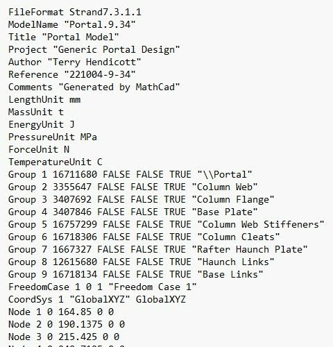

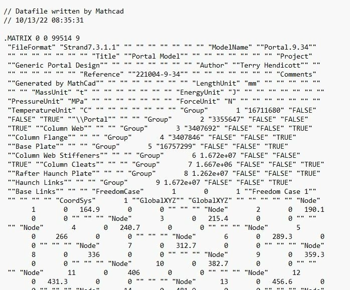

Step 1

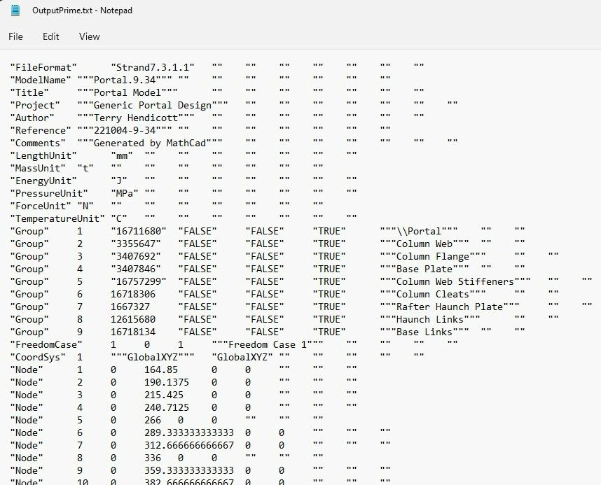

Save a text file with Prime this gets a text file that can be imported into Mathcad 15
The file has single quotes for single quote entries
Triple quotes for double quote entries
Look at the "Group" lines and you can see the Prime text saver is random in treating numbers as text or numbers but no matter this workaround negates that.  Who knows how many times it does this in the large file.
Step 2

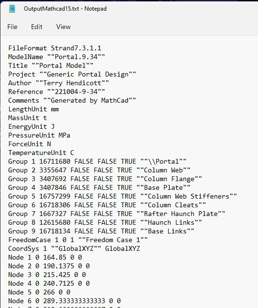

Run a Mathcad 15 file with only two statements using the built in file input and output components
This gets a file with single quotes gone and triple quotes as double quotes.
Note this fixed the group statements and codes are now integers like they should be.
Numbers are accurate not like WRITEPRN() statement in Prime.
Step 3
Replace in an ASCII editor the double quotes to single quotes and save.

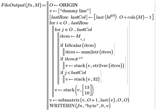

I, too, can't think of anything else than creating the large vector and using WRITEBIN.
I won't claim that my function in the attached file would be any faster than yours, but you sure have the large data at hand to testdrive it.
It looks to me that your version adds a blank line at the top of the output file. If thats OK for you you can change in my function the ["dummy line"] for [13,  10] and delete the submatrix command at the end.
Of course you may also change my CR LF (13, 10) for CR (13) only if that suits your needs better.

October 12, 2022
Hi Werner
Have been doing some testing and examination.
There are nearly 800,000 items in the matrix.  Majority of them are numbers.
AssemblyPRN() uses only one branch if/else test for this majority of items as numbers
Strings either "" or with values like "Quad4" only have to pass two if tests.
AssemblyPRN() takes 27 minutes to run.
FileOutput() performs three if tests for each item no matter what the item is so runs for a longer time
Currently at 1 hour 30 minutes and still not finished.
Think I will look at the Prime API over the next couple of days but not hopeful.  The API is set up to pass a matrix of numbers or individual strings as variables.  Does not look to cover a matrix made of strings and numbers?

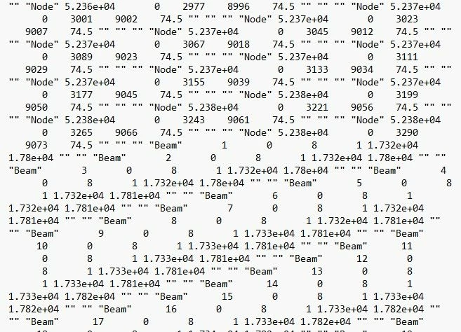

WRITEPRN was my first go to.  It takes the snap of the fingers to save the file not 27 minutes but!
The output from WRITEPRN is rubbish and enclosed should show you why.
WRITEPRN:-
Rounds decimal numbers, Mathcad 15 had two worksheet variables to cover column width and precision
Sometime interprets a large integer as text not a number
Sometimes puts a large integer in scientific format thus loosing information
Each line is all over the place.
27 minute file is ordered and looses no data.  This is formatted text output Mathcad 15 used to be able to do
WRITEPRN is rubbish because it looses important data

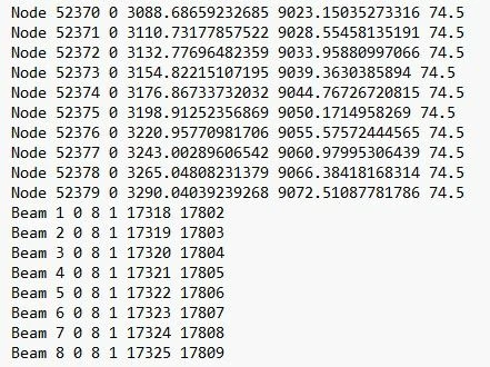

Hi All,
Really want PTC to realize how useless WRITEPRN is
The beams are connected to two nodes given by the numbers in the last two columns
Here is how WRITEPRN interprets this.
Beam 1,2,3, & 4 all now go between nodes 17320 and 17800 this is not what is intended?
Node 52380 is written five times?
WRITEPRN() looses valuable information of the FEM model.
