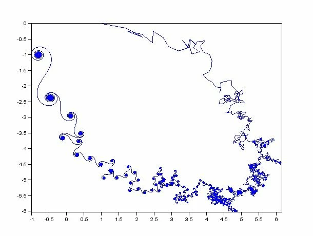

Plotting large data sets.  Here is the path of an optimisation technique.  It is slow needing millions of points.  Mathcad handles the technique but not the plot.  Done in scilab [It is free software].  Over 3,000,000 million blue points and one red point at solution in upper left corner in last swirl.

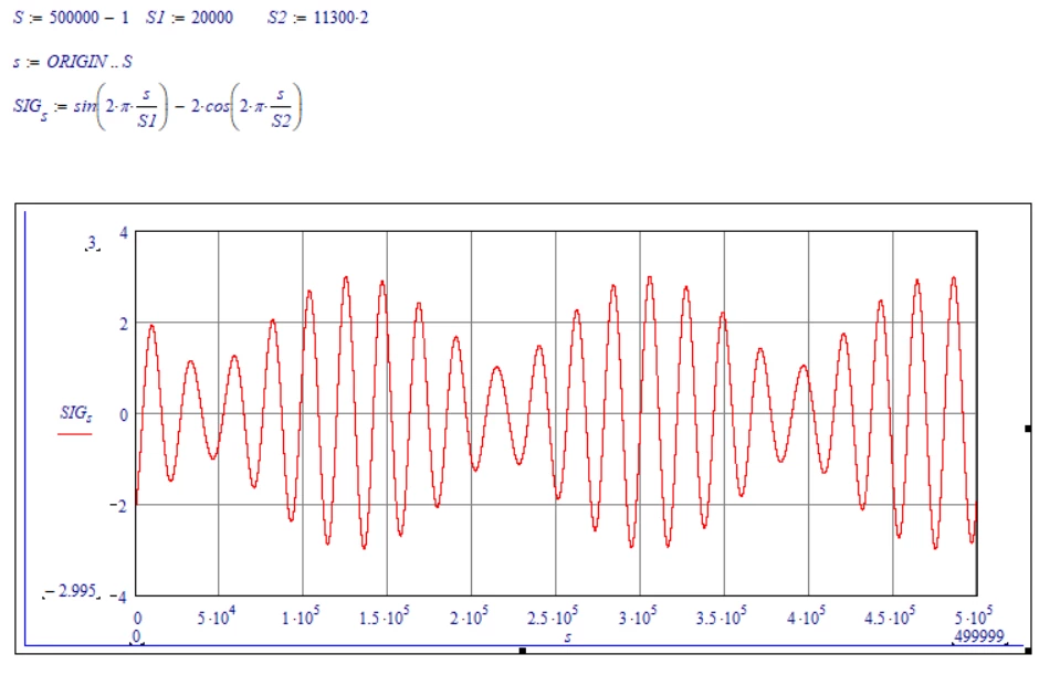

How many points? Mathcad 11 is limited to 500 000 points in a plot.

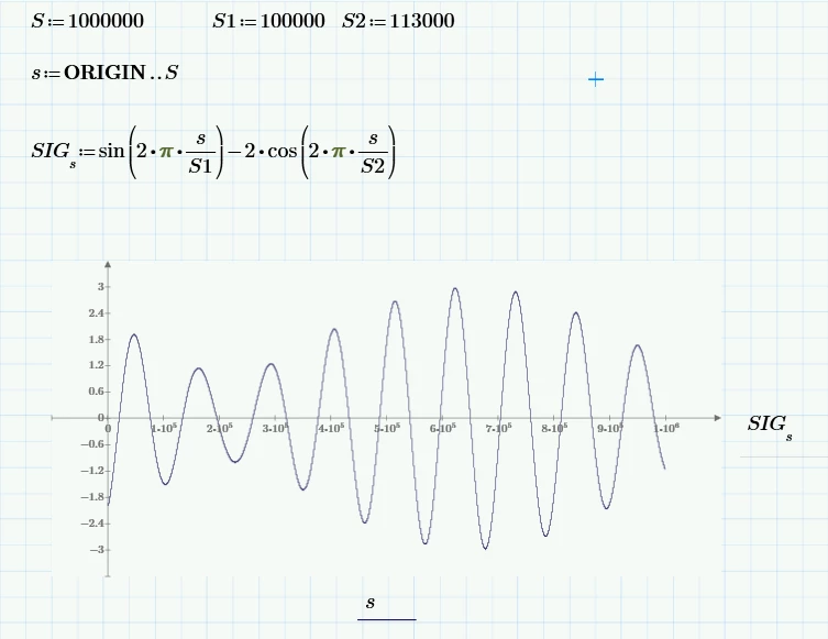

I have a plot with 1 million points in Prime 4 (on 64-bit Win10), and can still edit trace colour.
Notice that in order to edit trace properties, you have to select the (Y-axis) variable (SIG[s in the above example) in the plot that you want to change properties of.
