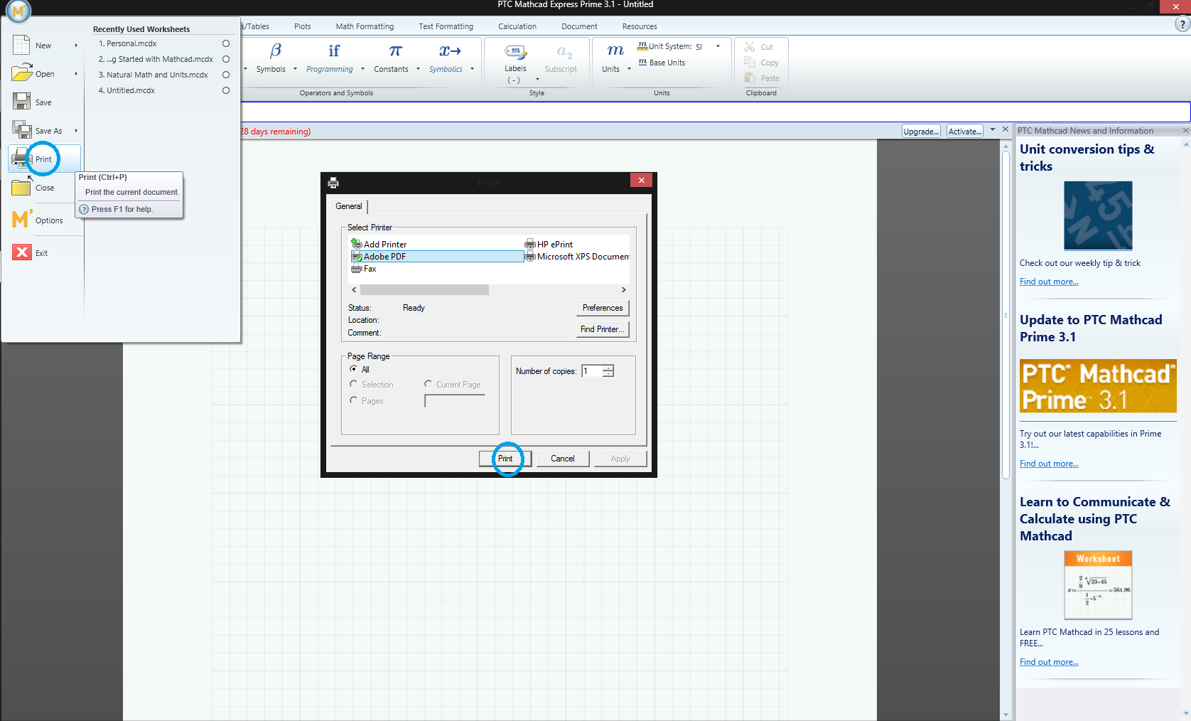

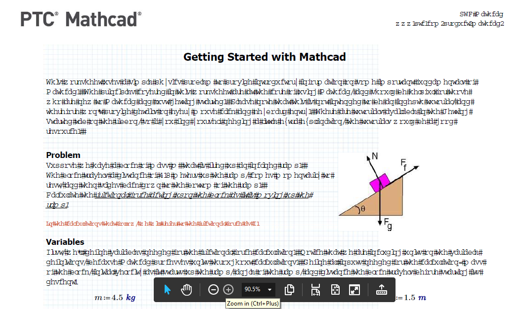

I tried to print to PDF an educational worksheet and this is the result.
                    Am I missing something?
RichardJAnswer
November 26, 2015
I don't see the same problem. Maybe it's related to the language settings. Try a different pdf printer. I use CutePDF. It seems to be very reliable.

I think it's a font problem.
Do you have the 'Tahoma' font on your system?
November 28, 2015
Thanks all for your responses. The problem was solved using CutePDF.
