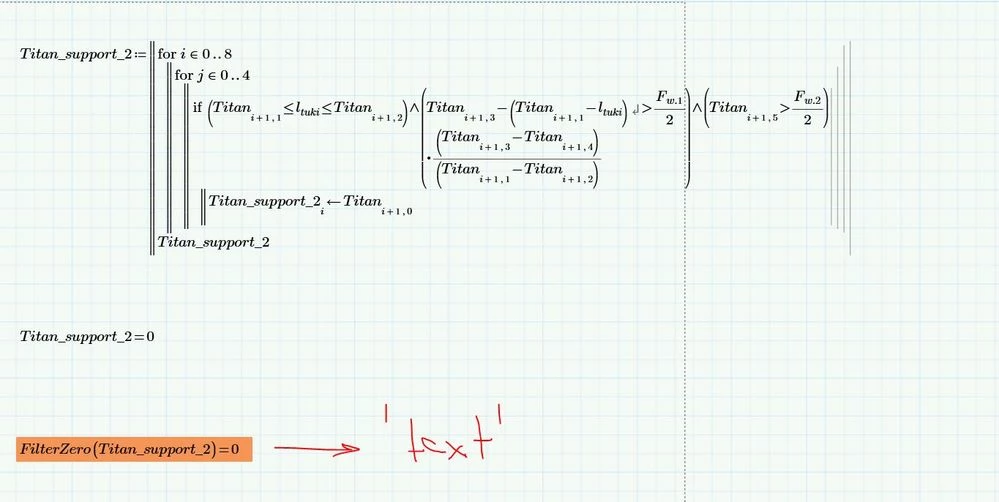

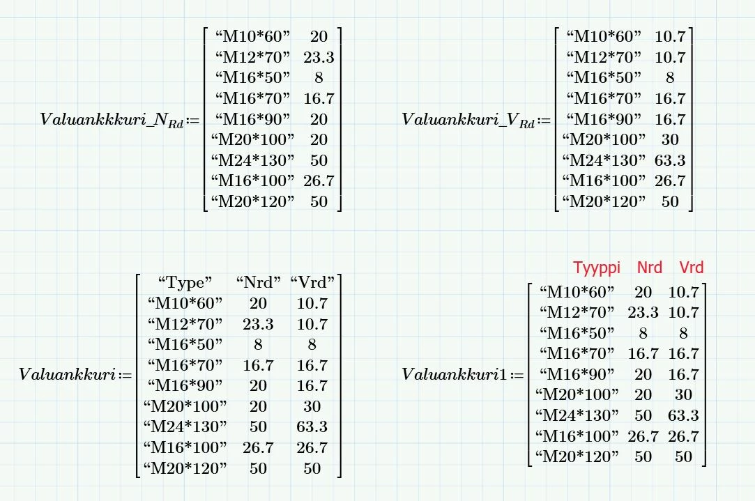

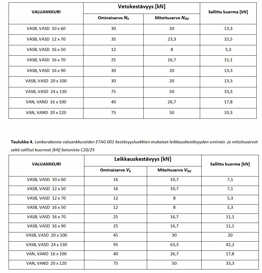

I have problem with printing name (types inner inserts) from tables (values picture). I have 2 values which are not in tables: N.Ed=31kN and V.Ed=35kN and then analogues/relatives values from tables N.Rd and V.Rd in columns. So i need to print all names from (vakuankkuri) column which are meet the conditions:
~N.Rd>N.Ed/2 and V.Rd>V.Ed/2
I have already ideas with matrix (picture matrix tables) but don't know how to solve this problem by right programming/looping. Thanks for advices.

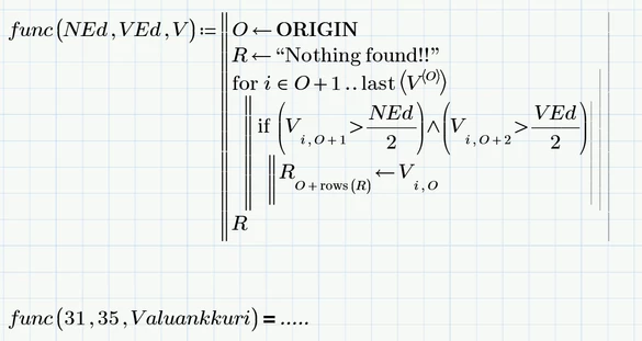

In case you'd like to stay with your solution, you may simply try this:

Please attach your worksheet.
And if you don't use the latest version of Prime (which is 6), tell us so, as otherwise you won't be able to read the files which may be posted as answers.
From what I understand, a function like the following should do the job:
P.S.: You may consider using units in your table(s). That's something that Prime can deal with pretty good.

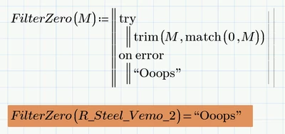

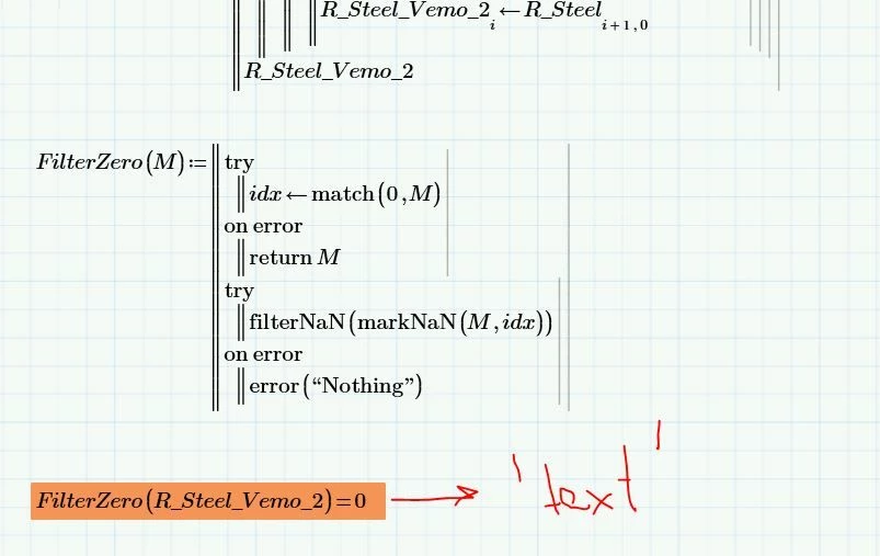

Im using Mathcad prime 5 and I did solve this problem in another way. In my opinion also works but i need to add some comments which I dont know yet.
How i can add output text: 'need more insert/supports per element'  if i dont how now types printed:
It will be also good to know how to solve this problem by you way

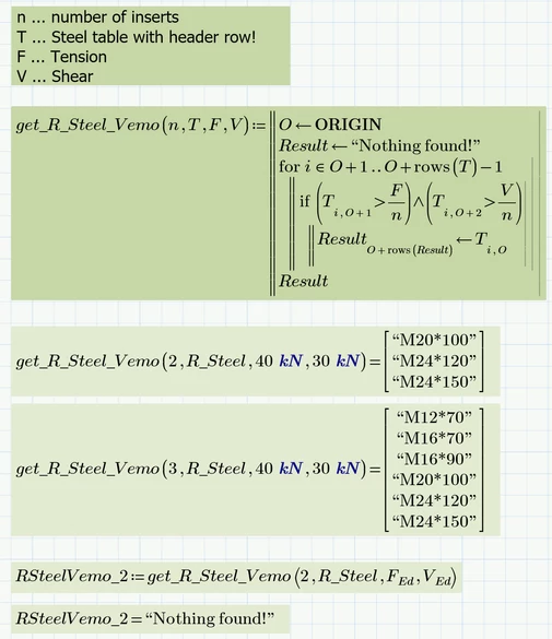

Feb 1, 2021 2:05 PM UTC
How about a more streamlined and general function which you can use for an arbitrary number of inserts?
Prime 5 worksheet attached
